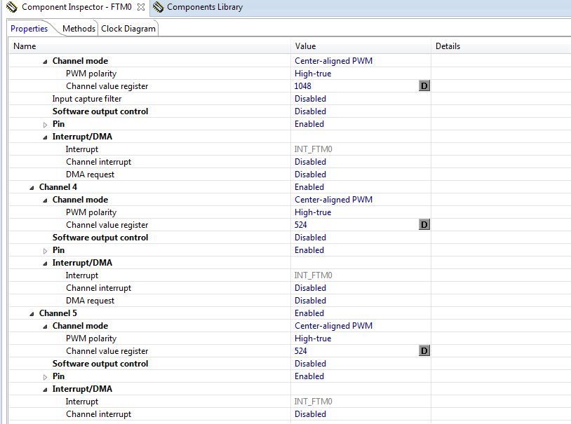

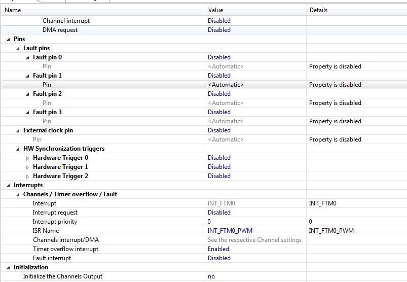

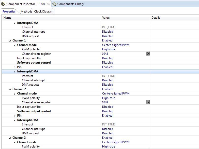

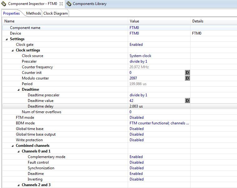

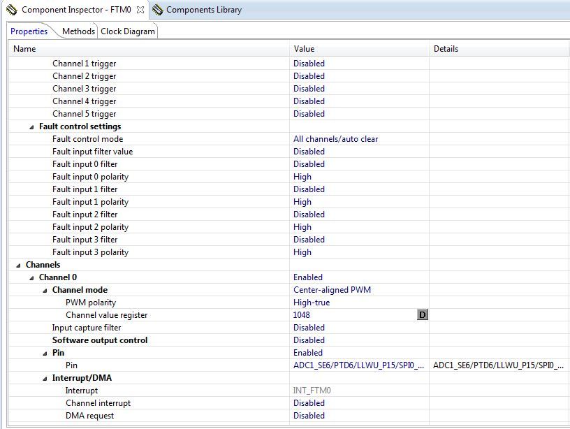

Hi, I'm using my own board of MKV10Z32VLC7 for motor control applications. I'm using center aligned PWM generated from FTM0.  And I just want to measure the current at the center of PWM and referred some application notes(AN4410, AN5142) and processed as such but the trigger is not happens correctly.

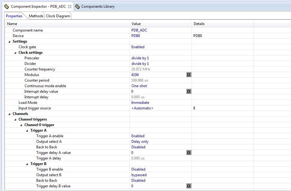

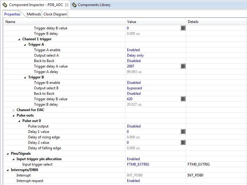

For example, I need to generate a PWM of 10KHz, I used the following configurations in FTM(FTM0 is used) and PDB.
Configurations for PDB as follows:
The output waveform for the above configurations as below:

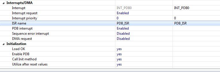

Channel 1(yellow) is FTM0_CH0 output and channel 2(green) is for LED toggle(450KHz as measured); the code shown below.
void PDB_ISR(void)
 DB_LED_NegVal();
I need to trigger at the center of PWM, so for that what should be the configurations. Due to this PDB_ISR the other interrupts(such as periodic interrupts) are disabled. MarMi pavelrech‌ kubanb‌ kubanb‌ vicentegomez‌ khumphri‌ Mandar‌ dhaval‌
