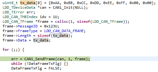

I've been having some trouble with sending out a CAN message from the TWR-SER board using the TWR-K40100M module on an actual CAN network (not in loopback mode).
Details:
Kinetis Design Studio 3.2.0
Processor Expert
CAN_LDD bean
TWR-K40D100M
TWR-SER
I am trying to achieve a successful CAN message transmission from the TWR-SER to an external CAN node.

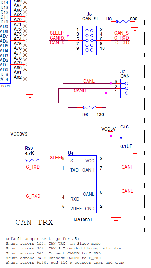

The test network is terminated at both ends (at the TWR-SER board and at the CANbus monitor device)!
On the TWR-SER module

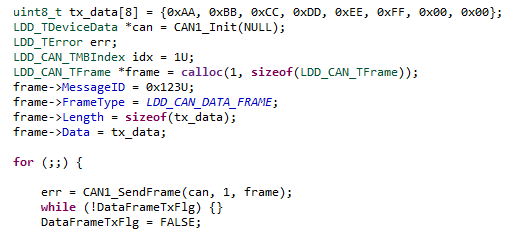

in main.c

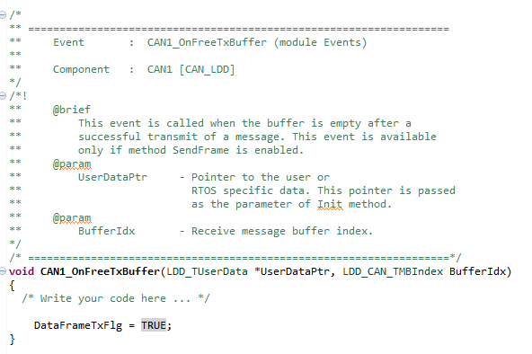

in Events.c:
On the K40D100M
  • Followed the example FlexCAN initialization from the help document
    • Interrupt-driven TX transfer (using Events.c)
When I initiate a CAN transmit message, the function returns an error code of 0 (ERR_OK), but then the program would hang at the while loop checking DataFrameTxFlg. During debugging, CAN1_OnFreeTx_Buffer never triggers. The entire hardware configuration is correct (as far as I know). The FlexCAN software initialization seems to be correct, but the CAN1_OnFreeTx_Buffer not triggering I am still unsure about.
Attached is my project.
Any advice / guidance is appreciated!

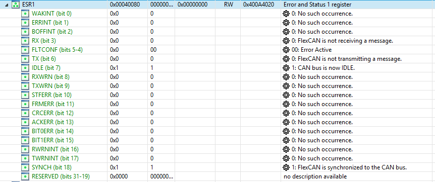

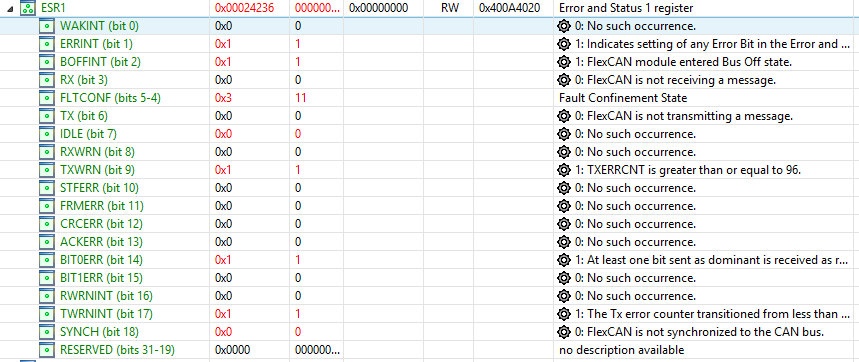

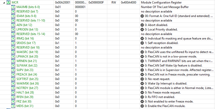

Update: I placed a scope probe on the CANTX header pin on the TWR-SER board (which connects to PTE_24 (configured as CAN_TX) on the TWR-K40D100 board.
  • The scope shows no signal activity when calling CAN1_SendTxFrame. I've verified from PTE_24 (CAN1_TX) / PTE_25 (CAN1_RX) on the TWR-K40D100M board to J5 pin  7 (CAN_TX) / J5 pin 5 (CAN_RX) the TWR-SER board.
  • I have good confidence that the TJA1050T CAN module does work, as I sent an artificial msg over CAN and see activity on J5 pin 6 (C_RXD).
So it leads to a few possible scenarios:
  • The CAN1 peripheral is not configured correctly (even using Processor Expert.
  • Somewhere from the expansion contacts to the MCU itself there is a discontinuity.
Here is the CAN1 CAN_LDD header showing CAN1 configuration:

xiangjun_rong
I think the jumper is okay to close all J5 on the TWR-SER board.
I have downloaded your code, but I faced some error when I compile and download. Anyway, can you check the CAN1 register to check whether the CAN1 register has be written?

efrencabebe
Hi Xiangjun,
Here are pictures of the relevant registers' values before the CAN1_SendFrame call:
relevant registers' values after the CAN1_SendFrame call, stuck at waiting for the DataFrameTxFlg to be set inside CAN1_FreeTxBuffer within Events.c:
