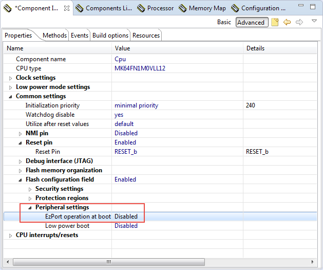

BlackNight
Hi Antonio,
the far most easiest way is to use Processor Expert: here you can easily disable the EzPort:
Erich

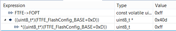

leonardobueno
Well, I did verified the value of the register when debugging. This value is the actual saved on flash, I suppose. As show bellow, the FOPT register is written with 0xFF. I can also check FSEC, and it is what it was supposed to be (0xFE).

mjbcswitzerland
Specialist V
Leonardo
What values do you see in Flash at 0x400?
This is what I read from my FRDM-K64F, when configured to disable EzPort and NMI:
0x00000400
00 00 00 00 00 00 00 00 ff ff ff ff be 01 ff ff  ................
When I read FOPT and FSEC registers they are the same:
0x40020002 be 01  ..
