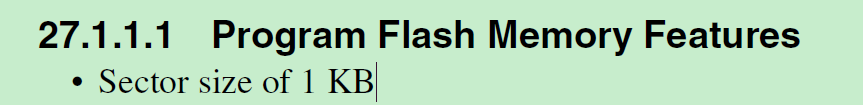

For the KL26 Flash sector size is 1KB, the sector erase address should be 1KB aligned.
For customer erase sector start address is 0x1FFF0, which is not 1KB aligned.
Please change the sector start address to 0x1FFC0 and try.
Wish it helps.
Ma Hui

yenhsu
Hi Hui_Ma,
Sorry for late response.
I tried your approach to change the start address but the lockup reset does still happen.
Could you have other ideas to solve the issue please?
Thank you.
Chris.
