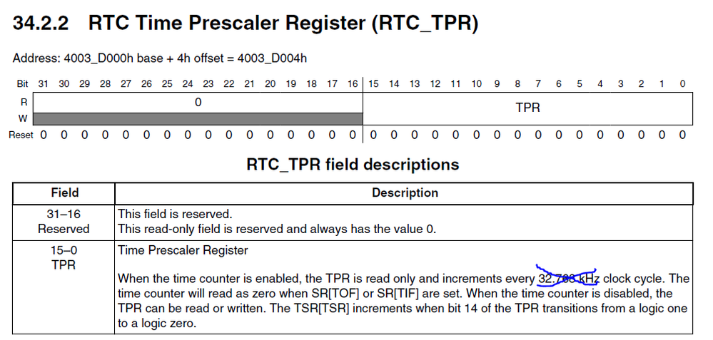

mjbcswitzerland
Specialist V
Paul
The RTC has a pre-scaler register called RTC_TPR which counts at the clock rate. This allows 1ms resolution from LPO or 30us resolution with external 32kHz.
I have crossed out the 32kHz clock since it actually increments at the "selected" clock rate.
Beware that the LPO is not very accurate so there may be several % of drift.
Mark

ppd
Ah, I overlooked the prescaler register.... Well then this is just what I want. I'm not looking for accuracy so this is just perfect. Thank very much for your help!
