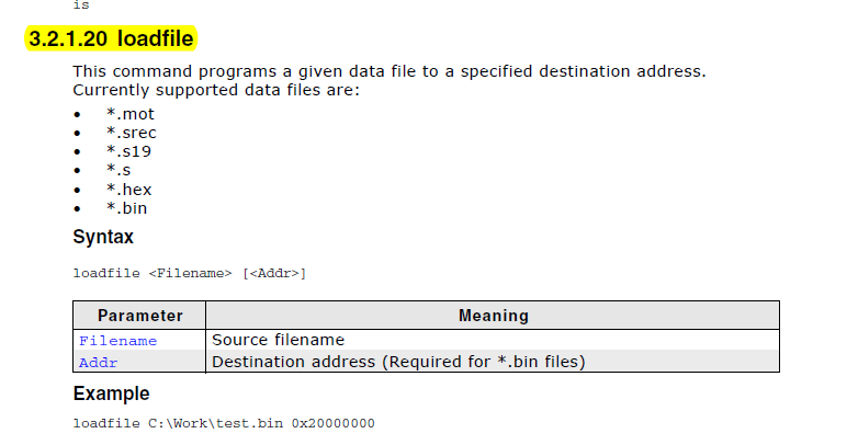

kerryzhou
Hi BC,
    If you just want to download the binary data to the flash, you don't need to use the KDS.
   After checking it with our KDS engineer, the KDS have the .bin file download problem.
   I suggest you generate the .bin file at first, then use the JLINK commander associated with JLINK debugger to download it.
  The JLINK commander can input this command to download the code:
 Wish it helps you!
Kerry

bcstewart
Thank you.  That is a good solution.
