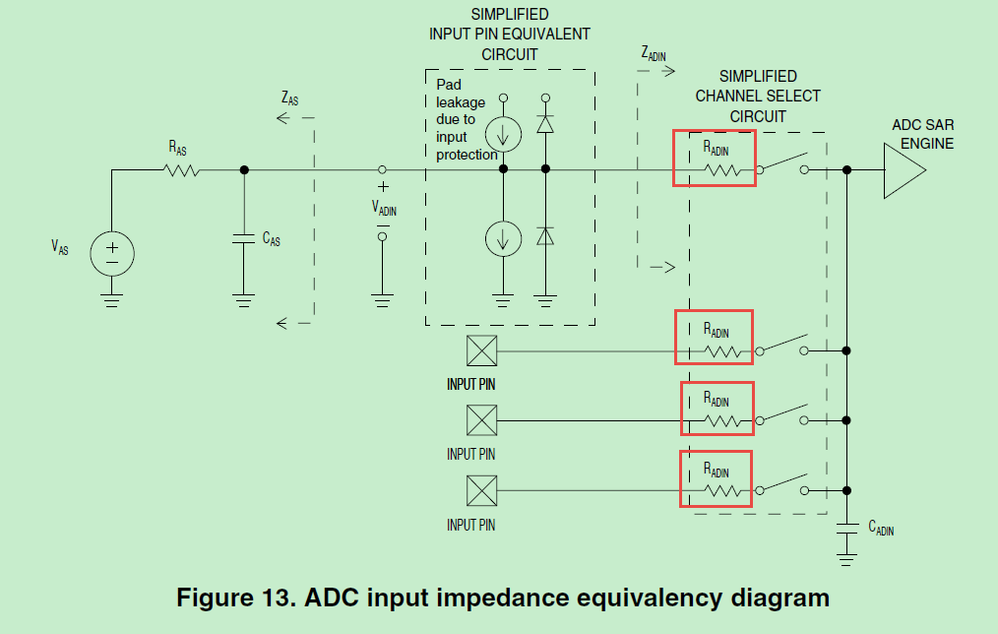

I have a circuit with 100K thermistor in series with 25k resistor to ground. I connect my adc input to the point where
the thermistor and resistor connect and also a capacitor. This approach works on some adc channels but not others.
reading through the datasheet I notice there is an internal adc resistance of 5k Ras. So it appears having a high impedance input circuit may be an issue.
Is there a reliable way to make this approach work ?

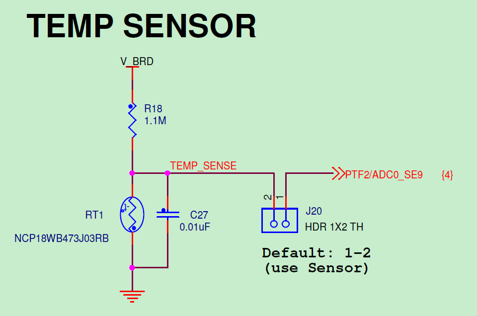

On some of the eval boards like the FRDM-KL03z I notice they use lower value 10k NTC with 5k above and 5k below in series with 2 adc channels. Why do they do this as compared to approach above.

The TWR-KM34Z75M board provides below temp sensor circuit:
Customer doesn't need to use the serial resistor R, for the ADC input equivalency diagram shows there with serial Radin (input resistance), which typical value is 2Kohm(Max. value is 5Kohm). Or customer can use a very small serial resistor R, such as 100ohm.

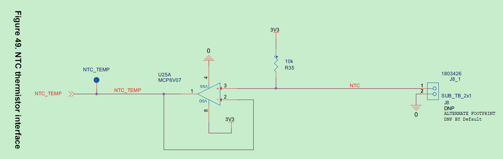

The FRDM-BC3770-EVB provides below NTC thermistor interface circuit design:

The Ras (analog source resistance) Max. value is 5Kohm, while there with below note:
This resistance is external to MCU. To achieve the best results, the analog source resistance must be kept as low as possible. The results in this data sheet were derived from a system that had < 8 Ω analog source resistance. The RAS/CAS time constant should be kept to < 1 ns.
The FRDM-KL03Z board using below thermistor circuit to enhance the system robust.

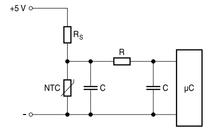

Customer also could consider to use below circuit:

Thanks for reply. On second circuit are there any guidelines for Rs, R, and NTC resistance ?
How about the capacitors ?
Since this is a slow changing signal measuring temperature can high values for the Resistors and NTC be used ?
100k + ?
The reason I ask is this is common approach, but power consumption is very important and must be minimized.
If you can use high resistance devices what software configurations of the ADC are optimal ?
