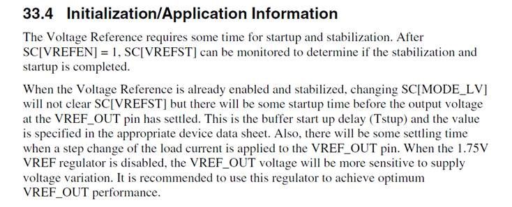

Regarding VREF, there is something strange.
In the reference manual, it’s written:
In the datasheet, tstup is given for a maximum of 100µs.
As you can see it on the following screenshot, VREFST flag takes about 6µs to be set (after VREF startup) and VREF_OUT takes more than tstup (100µs) to be stable.
So, we wonder why VREF_OUT takes more than 100µs to be stable and if it may have a link with our calibration issue.

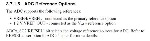

In the reference manual, it is written that ADC used VREF_OUT as reference and not internal bandgap voltage.
So, if we start ADC calibration just after VREFST is set, VREF_OUT is still not stable and calibration is done with a reference that is not stable.

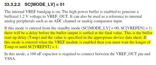

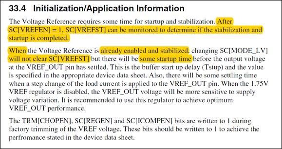

phil74
After performing several tests, it appears that changing cap value does not change the calibration results.
The only good results are obtained if we wait for Tstup (100µs) when VREFEN is set.
But according to the RM this Tstup delay is only needed when VREFEN is set and only when switching from one MODE_LV mode to another  one:
Can you confirm this, as it appears from our tests that setting VREF_SC = 0xE1 (meaning set VREFEN and MODE_LV=1 simultanously) we also need to wait for Tstup to get correct results.

phil74
I can understand that capacitor need time to be charged, but measurements have shown that 100µs is not enough to fully charge this capacitor. The response time (at 5%) is around 250µs. Is it enough to wait 100µs ?
Moreover, in the reference manual, it is not mentioned to wait Tstup when the VREF enable switch from 0 to 1.
According to RM, I understand that Tstup must only be waited when VREF is already enabled and mode is changed.
Note as well that the capacitor on VREF_OUT is not 100nF as mentioned in the RM but 2x100nF in series = 50nF.
For the first designs we only had one 100nF. Is there a link with our issue ?
Philippe

xiangjun_rong
You use 1.2V VREF_OUT output voltage as the ADC reference voltage, because the VREF_OUT have to be connected to a 0.1uF capacitor, the VREF circuit has to charge the capacitor, the voltage of the Vref_out is rising based on the formula V(t)=1.2V*(1-EXP(-t/RC)), so time is required to charge the capacitor.
If you use the 1.2V Vref_out pin as ADC voltage reference, you should wait 100us as you said so that the transient process is ended, Vref_out voltage is stable, then you can do ADC calibration and have ADC sample.
