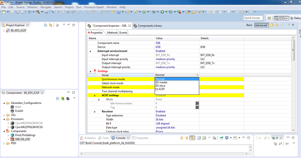

xiangjun_rong
This is PE screenshot of IIS module using KDS tools.
Xiangjun Rong

negarerfanian
Hi xiangjun,
Actually I am using PE but I was not using SSI_LDD. I was using init_I2S. now I'm gonna change it.
The problem is that after I initialize it I want to receive data and send it to transmitter. First I need to enable both transmitter and receiver . what about channels? Shall I enable them too?
another thing that I was considering is that I'm checking FRF bit to see if it's 1, it will put data from receiver data register into transmitter data register. but it seems that it's never set. am I doing sth wrong?
