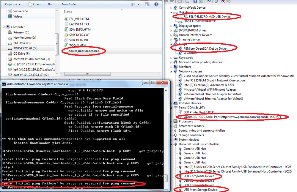

Hi All,
When I follow the guide "Demo Application User's Guide for the FRDM-K22F and TWRK22F120M Freescale Platforms" to connect TWRK22F120M, it can show in device manager but can't be ping with "blhost.exe" command. Nor does connect by KinetisUpdater.exe.
I'm just wondering if the driver has been setup correctly. But everything are shown in device manager. I'm puzzeld on the failure...

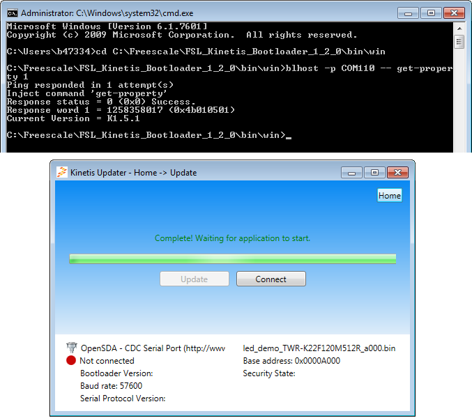

Can you share your jumper configuration? In particular the setting of jumpers J29 and J30 should be pins 2-3 shorted when using the TWR-K22 in standalone mode (without the elevators).
Your problem is indeed strange. I tried from my side with a TWR-K22F120M and it worked with both: blhost and Kinetis Updater. See below:

I double checked the jumper configuration, especially the J29 and J30. They’re with 2-3 shorted. The other jumpers are in default; same as guide.
I tried to debug with the OpenSDA usb on IAR and it can work. I believe it’s connected.
But I’m still puzzled on the blhost and Kinetis Updater.
