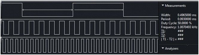

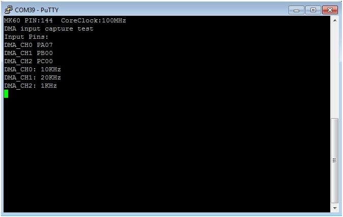

Here is my test result:
Below picture show the result of using DMA to capture three different square waves with different frequency (10 KHz, 20 KHz and 1 KHz).
