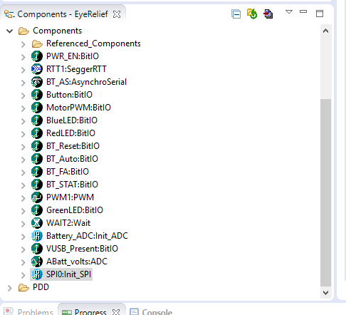

Below is my components section:

Sorry but I can't help with the component inspector - but it is only generating a few lines of code for you (which you should also understand if you are going to be responsible for a product development).

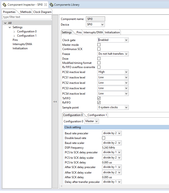

briancavanagh
Hi Mark, I'm finding it confusing to use these recommendations, but thank you for responding.
I'm using KDS and want to setup SPI0:Init_SPI ?  There are questions I'm not clear on how to answer.
Below is just a screen capture of the settings tab.  Is there any examples on how to set this up using the 'Components Inspector' ?
