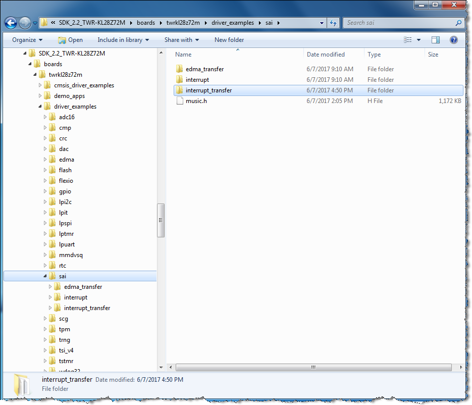

There are several SAI examples in SDK_2.2_TWR-KL28Z72M. Maybe you can refer these examples.
