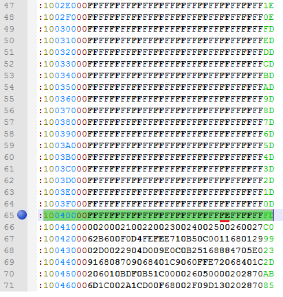

Hi, I'm using KL26; Someone tried to use flash protection with IAR?, I tried to do this by modifying the FSEC register from the .Hex file but I did not get it.
I use the j-link programmer.

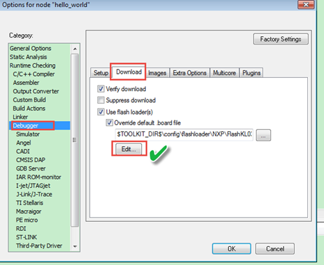

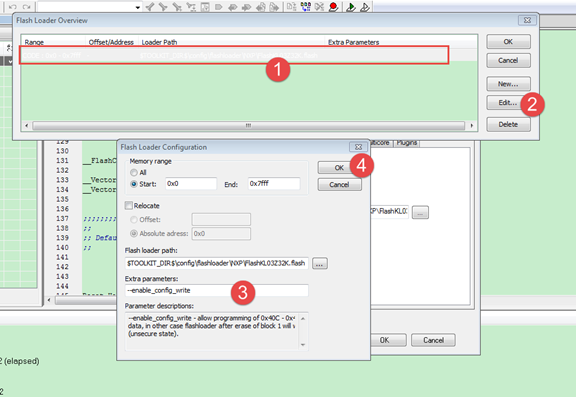

    IAR is special to modify the flash configuration field, you need to do some configuration in the options.
  After you modify the FOPT FSEC filed, do the IAR option configuraiton like this:
 Project->options, click the below edit button.
Enter :” --enable_config_write “ in Flash loader configuration windows.
Save the .board file as another .board, and choose that.board.
Then try again.
Wish it helps you!

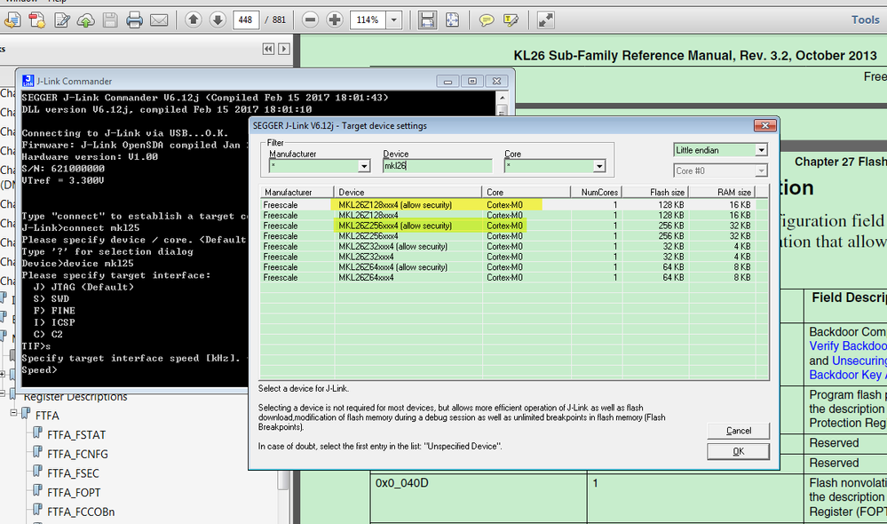

   If you modified the FSEC, you need to do the reset, then the debug interface will be secured.
   Actually, you can modify the code lash address 0x40c, then download it to the flash, do the reset.
  When you use the JLINK programmer, you need to select the MKL26 allow security, otherwise, the flash configuration field won't be modified.
Please try again.
If you still have question about it, please let me know!

enriquelopez
It has not worked for me.
I am trying to modify the FSEC register from the .hex file but it has not worked.
I want to enable read and write protection flash loading the FSEC register with 0xCC.
How can I change the FSEC record from IAR software?.
