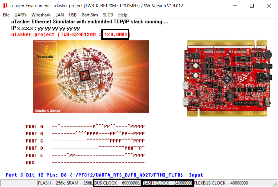

Assuming you want to use the PLL to generate 120MHz (and max. speed clocks) the configuration is:

Simulation, showing clock speeds achieved:
