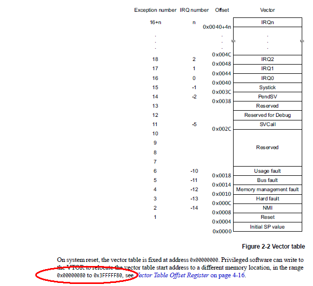

I successed load my code into ext ddr2 ram, but the PC register is not point to the boot.o address while should be 0x70000XXX, then the program is not running.
Did I miss out something need to do?

Hi ,
The issue you met is due to the interrupt vector table is out of range. It should be relocated in a address from 0x00000080 to 0x3FFFFF80, but you put it started from 0x70000000. Please kindly refer to the following for details.
You may also refer to DUI0553A_cortex_m4_dgug.pdf for more details, which can be downloaded from www.arm.com.
Hope that helps,
