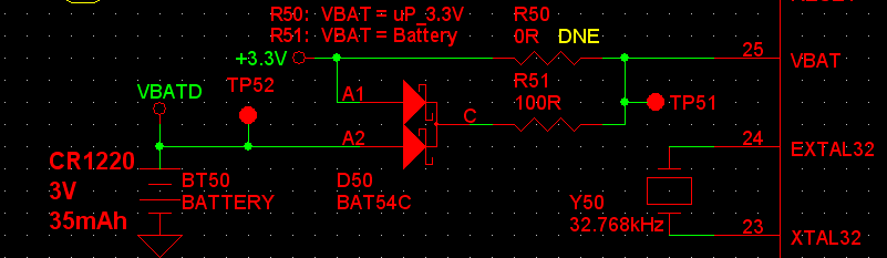

egoodii
Senior Contributor III
I am not surprised that the RTC subsystem must be powered-up to access the registers.  The 'normal connection' is a BAT54C to VDD and coin-cell, thence 100ohms surge-limiter to the VBAT pin.  If, when you power it up 'so connected' but if no/invalid coin-cell voltage came 'previously' you should get the VBAT_POR (Power On Reset) indication.

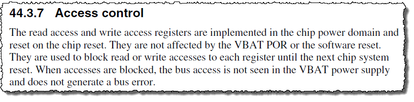

Amit_Kumar1
HI Earl
Thanks for the schematic. I went through the schematic of the TWR board which had this type of setup. I wanted complete isolated setup for the RTC.
In the reference manual I found hat some access control register is there which can be read. I wanted to know where is that?

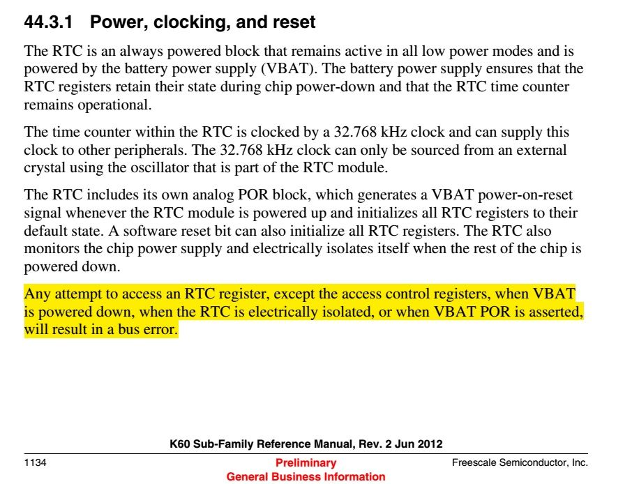

Jorge_Gonzalez
Hello Amit:
Just in case you did not find the answer to your last question:
Access control registers refers to RTC_RAR and RTC_WAR registers. As you can read in the manual, these registers are not powered by VBAT:
Regards!

Amit_Kumar1
Hi Jorge
Thanks for your valuable reply. I tried reading all the register one at a time. In that process I tried reading the above 2 registers which you mentioned. But when Vbat is not powered, The program hangs at the reading statement. If VBAT is powered then I am able to read all the registers. But this won't solve my issue.
