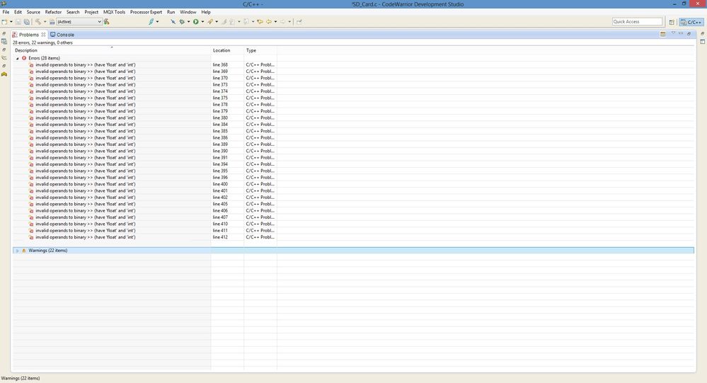

This method of storing floating point didn't worked for me
I tried the following
buffer[0] = (uint8_t)(a>>24);
buffer[1] = (uint8_t)(a>>16);
buffer[2] = (uint8_t)(a>>8);
buffer[3] = (uint8_t)(a);
my buffer size is greater than 4. the following result I got.  I tried using int also but the error was same.
I somehow made it error free by changing the syntax but in that process the float became integer with floating values being skipped.
buffer[0] = (uint8_t)(a) >>24;
buffer[1] = (uint8_t)(a) >>16;
buffer[2] = (uint8_t)(a) >>8;
I removed the datatype and then tried again the above error appeared.
buffer[0] = (a>>24);
buffer[1] = (a>>16);
buffer[2] = (a>>8);
buffer[3] = (a);
Is there any other way to make it happen? as my buffer will be of around 100 bytes and the i/p to it will be all mixed it will be of varying data types

Hi Amit,
You will need to study up a little more on the C programming language.
If a is of type float then the compiler will not allow a >> 8. A bitwise shift operator doesn't make sense for a float. This is why your first example did not work.
In your second try you first cast the float to an 8-bit integer and then shift it. This is legal but not what you want. If a is 1.125 the cast will convert this to the integer 1 and then shift the result--you are losing all your floating point information.
In the third example you are back to shifting a float.
A way to do this is to use a union. It tells the compiler that you'd like to interpret a piece of memory as different data types. In this case you have four bytes that you want to interpret as either a float or a 32-bit unsigned number.
