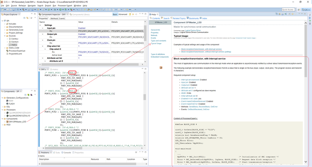

wenn I try to setup an SPI Master component with MK20DN512ZVLL10 in processor expert, the pre-defined pin name values for SPI1 are reversed. (Output: PTE1/SPI1_SOUT; Input: PTE3/SPI1_SIN) so that it´s not possible to configure a master application. How can I manually change the standard values displayed in the drop-down menu to get the right configuration?
Regards Felix

Not sure what you mean.
If you are using SPIMaster_LDD, then please refer the Typical Usage of it.

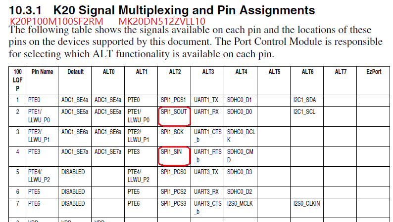

Considering that you are using MK20DN512ZVLL10 chip, so see its reference manual K20P100M100SF2RM.
I am afraid you are refer K20P100M100SF2V2RM, that manual is for MK20DN512VLL10.

Hi Robin,
thank you for your reply. I was just wondering about the designations of the pins. For an SPI-Master application the input pin should be named MISO but in the component inspector it is called S_IN so this lets assume that the driver uses this pin as MOSI. But as I found out there was onother issue on my board and this was the reason for my SPI dis-function. So now the SPI master works as aspected with MOSI on PTE1(SOUT) and MISO on PTE3(SIN).
Felix
