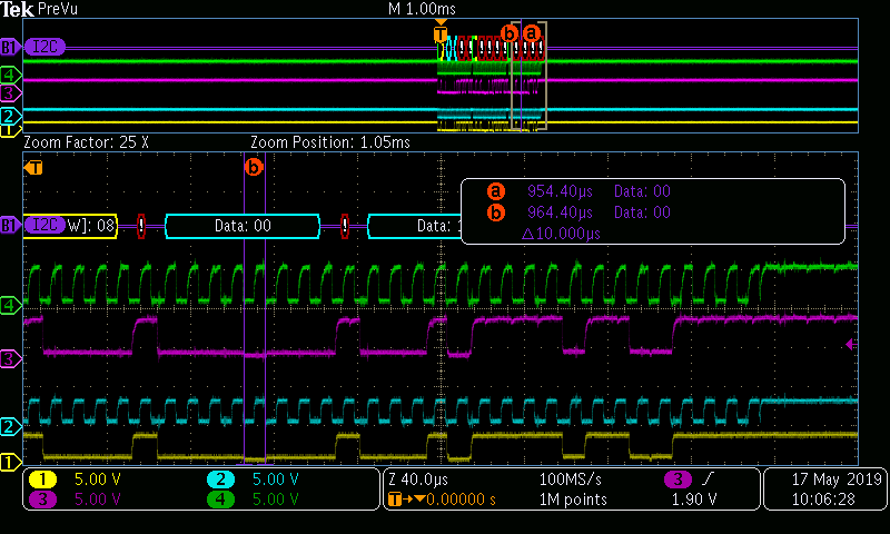

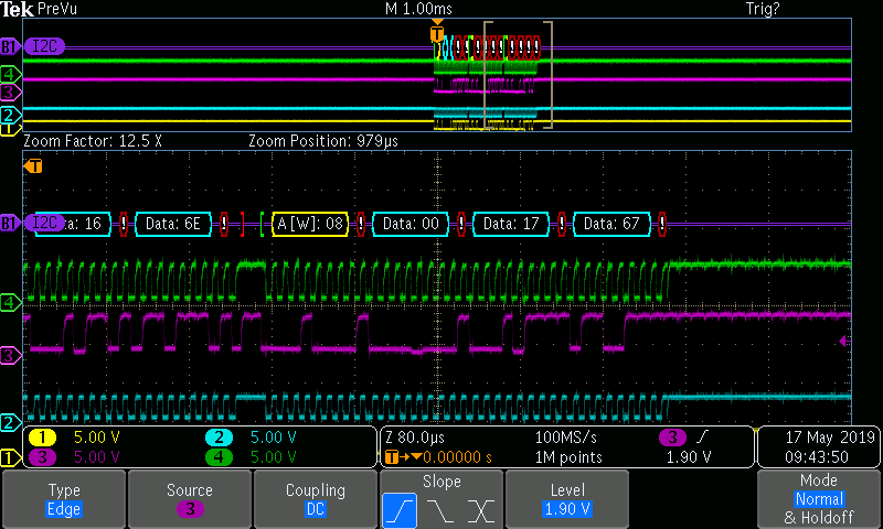

We captured an event and I am trying to understand how the peripheral could fail to generate a stop condition.
What we are trying to send: start 00010000 (address 08, write)  00000000  00010111  0110 1110 stop
But the slave is confused and is out of sync.  We don't know how it could get confused; that's a question for the manufacturer of the slave.  The slave doesn't ack on the 9th bit, but it is obviously acking on the 5th bit of the 00 data byte (scope shows SDA at a different low level for one bit time; see cursors in 2nd image) and on the 5th bit of the 17 data byte (again, SDA seems extra low) and perhaps on the 5th bit of the last data byte, changing it from 6e to 67.
Clearly our driver should stop sending when it detects a nack rather than plowing ahead, but what I'm interested in at this point is correct stop bit generation.  When we clear MST in C1, why does the K21 not bring SDA low to generate a valid stop?
Secondarily, how does the peripheral react when it sees a mismatch in the data it is transmitting (sending 6e but bus says 67)?  A few bits after the mismatch occurred, why would it not transmit a 0 for the LSB of 6e?  The ARBL arbitration lost bit was not set.  But is it possible that the data mismatch results in the IICIF bit set before all the data bits are transmitted, leading to the driver clearing MST too soon, and, without SHE enabled, the stop bit generation gets messed up?  Is the logic is different for the arbitration lost case of IICIF versus the ARBL bit?  FWIW SSIE is 0 and the SMB, SLTH, and SLTL regs are all 0, so they aren't affecting IICIF.

1. I note that your slave is not responding (no ACKs) before the frame where it looks like it may be be sending ACKs at an unexpected time.
2. If your slave is indeed acking in the 5th clock cycle (rather than in the 9th) it would cause the last data byte to be sent to appear as a 0x66 rather than a 0x6e (since it pulls bit 5 low - b01101110 becomes b01100110). What happens to the final bit (seen as 1') will depend on how the master responds to detecting an arbitration loss. Presumably it will lose arbitration and stop sending data, meaning that it would be '1' and thus a 0x6e.
3. Assuming this behavior is causing the master to detect loss or arbitration it must be reacting to the arbitration loss - the loss flag needs to be reset in SW for it to go back to '0'.
4. I agree that if you are losing arbitration but the driver doesn't handle this case it may well then not be able to send the STOP condition correctly. In fact if arbitration were really lost in a multi-master bus environment the losing master should completely back-off and so it would also be normal to not send a STOP condition.
5. In a single master system I don't see any reason to not send and receive data to end when the slave doesn't ack. This doesn't cause any problems because tx data is still send (clearing output buffers) and reception just receives 0xff (usually allowing the next firmware layer to detected that something is amiss).
6. If you can prove that the slave is not behaving correctly it sounds like an underlying HW issue. I have never experienced such behavior from a slave I2C device (apart from an ASIC that once had a bad implementation and caused some clock glitches, which can't really be compared). In your case I see that there was a good start/stop just before the issue, which would normally have reset the slave.
7. If you can detect the arbitration loss and you can verify that the basic issue is a HW problem at the slave I think that the onl method is to switch the I2C bus to GPIO mode - generate pattern that set the slave back to a known state and then restart the I2C mode again.

Thanks.  Your confirmation that the peripheral (not the driver) automatically backs off and does not issue a STOP condition was what I needed to know for now.  I can take it from here doing the experiments you described.
