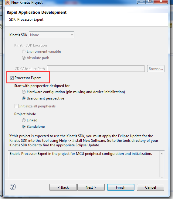

I would like to test the LED on/off after building the MK20DX in KDS(Kinetis Design Studio) enviroment..
so, I was downloaded the SDK_2.0_MK20DX256xxx10.zip in NXP site.
However in the SDK_2.0_MK20DX256xxx10 file, only provide example source of MK60DN.
I can not find the example file for MK20DX.
I don't know how to fix it to test the MK20DX.
Please help me.
thanks.
1,146 Views
Hello Park,
Sorry the KSDK doesn't support the chip MK20DX256VLH7 so far.
I recommend you use the Processor Expert, it is also a useful lib :
Hope it helps
