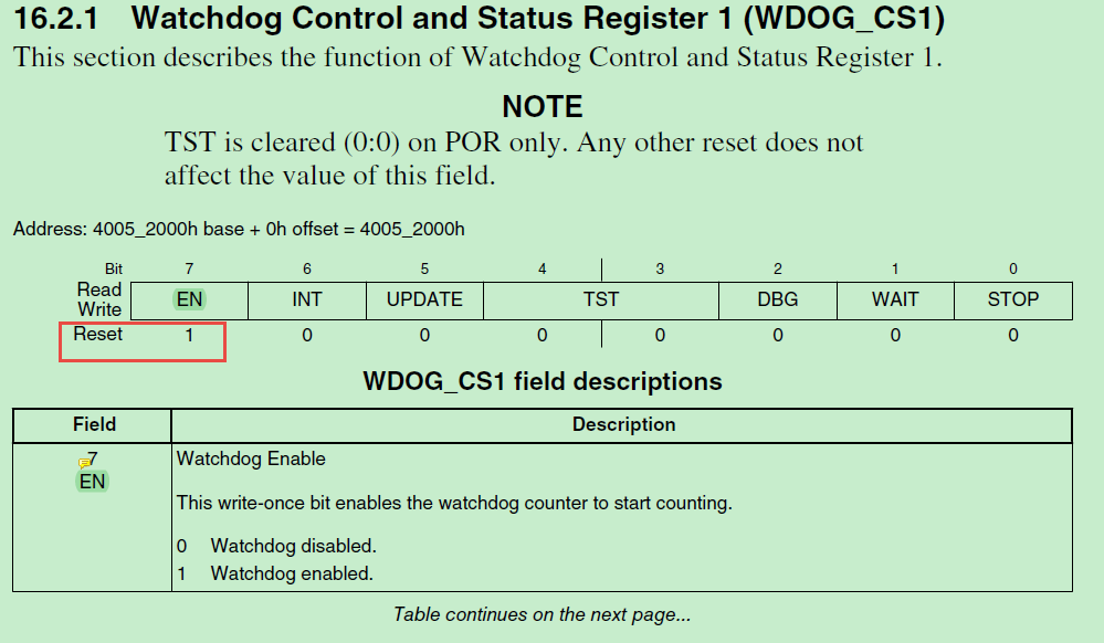

     Your phenomena is correct if you didn't disable the watchdog in the code after reset.
     You can find it from the KEA reference manual:
The watchdog is enabled after reset!

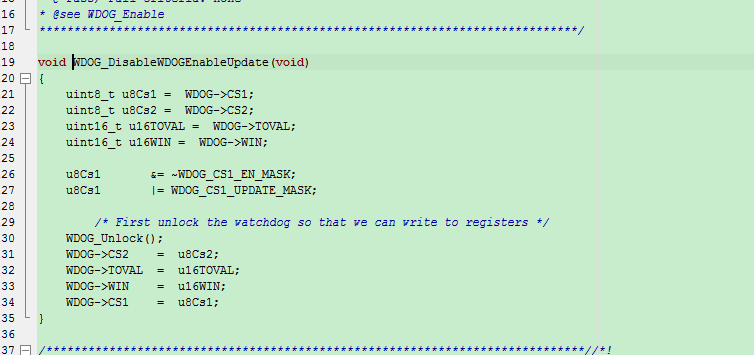

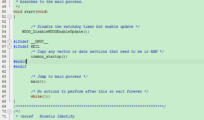

If you don't want to get the watchdog reset, you can disable it in the code.
The code you can do it like this :
Wish it helps you!

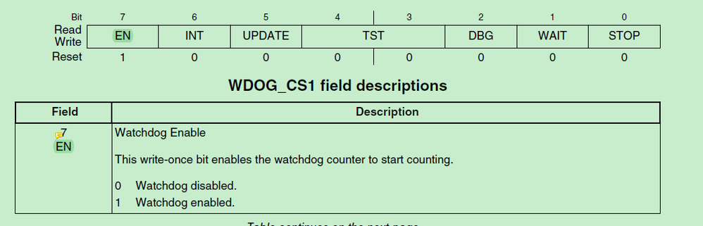

               I get it, how to Disable WatchDog on Startup. I want to know how WatchDog is Enabled after reset ??? Is it a Hardware Trigger to Enable WatchDog After Reset, if so that is not Given in the User Manual ?

    The watchdog is enabled after reset, it is the default value, and it is the chip hardware design.
    Just as the picture which I give you before from the reference manual:
EN bit is 1(watchdog enabled) after reset, it is the chip hardware character.
