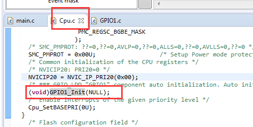

I am working on the MK22FX512VLK12
I have noticed that Even though I have PTA:Init_GPIO when I use GPIO1:GPIO_LDD I need to use an Init function even though an Init function already exits in the PE_LOW_level_init(); function.
to elaorate
in main() > PE_low_level_init()
there is a function PTA_Init()
and when I used GPIO1:GPIO_LDD
(under typical usage)
I see that I need another init function?
Component documentation - Typical Usage
LDD_TDeviceData *MyGPIO1Ptr;  void main(void) {   ...   MyGPIO1Ptr = GPIO1_Init((LDD_TUserData *)NULL);        /* Initialize the pins */   GPIO1_SetFieldValue(MyGPIO1Ptr, Bus, 0b1100U);         /* Configure the output value */   /* Output values: PTA12 = 0, PTA13 = 0, PTA14 = 1, PTA15 = 1 */ }
Why are there two init functons? could I use GPIO as well as the other periphrials without the LDD device?

Hello Jace,
About this "
DO you meaning the GPIO1_Init(NULL):

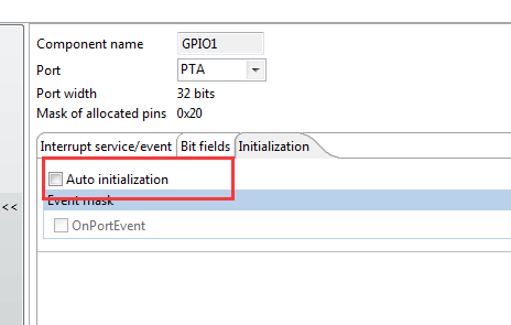

If yes, you just need disable "Auto initialization" of the GPIO1_LDD component , it will disappear:

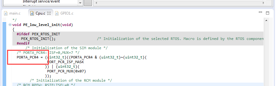

If no,  do you meanint the PTA4 ?
This is initialize the PTA4 to NMI_b function .
