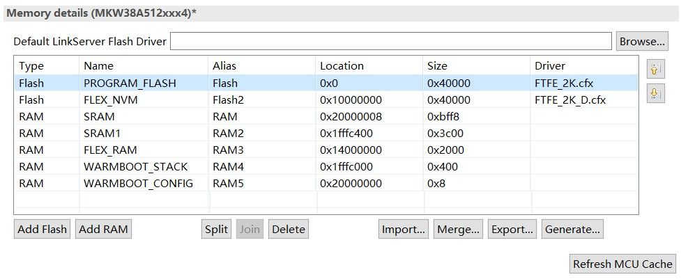

Hi everyone,
I use MCUXpresso IDE (V11.2.1) to develop the function of KW38, and use feedom bootloader to boot the BLE application through the UART upgrade of KinetisFlashTool.exe tool, but I don’t know how to allocate the FALSH and RAM space of the BLE application to correspond to the FLASH of the feedom bootloader , RAM space can be upgraded by this method?
Freedom bootloader FLASH and RAM space are as follows:
BLE wireless_uart_bm FLASH and RAM space are as follows:
The names of FLASH and RAM, FEFT_2K.cfx, FEFT_2K_D.cfx, do not know what they mean, is there any relevant documentation?

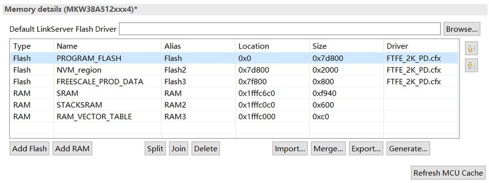

nxf56274
If your bootloader will go to address 0xa000, you can configure like this.
You should modify the application's Location and the size.

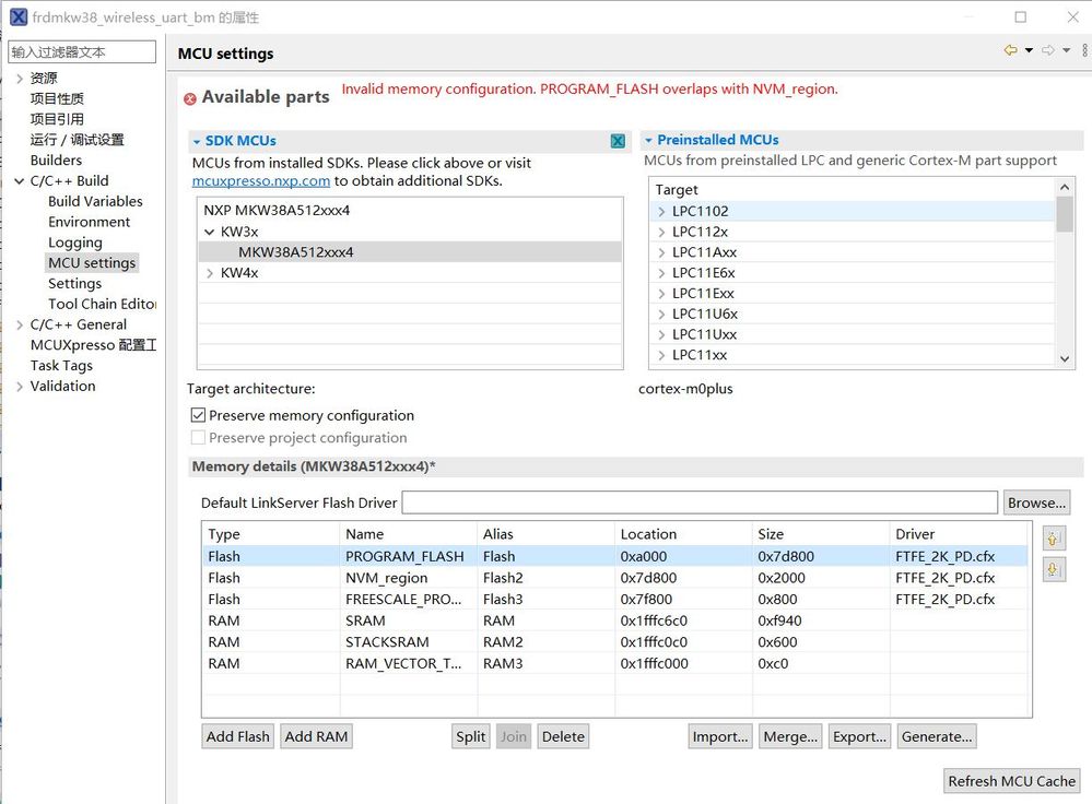

wenhuafeng
Hi,TIC
Modify here, there is an error message!

nxf56274
You do not modify the application's size.
