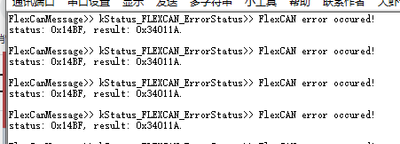

I'm trying to configure a 5 Mbps baud rate for FlexCAN on a KW45 microcontroller. The available clock sources seem to be 48 MHz or 32 MHz, which don't allow for an exact 5 Mbps setting. Any suggestions on how to achieve this?

I have tried setting the 'bitRateFD' to 5000000 as per your suggestion, but unfortunately, the communication fails at this setting. However, when I set the 'bitRateFD' to either 2000000 or 4000000, the communication works fine.
I suspect that this issue arises due to the clock frequencies available for CAN on the KW45, which are 48 MHz and 32 MHz. These clock frequencies might not be able to generate an exact baud rate of 5 Mbps.
If you have any further suggestions or insights regarding this issue, I'd be very grateful.

Thank you for pointing me toward the reference material. I have reviewed Chapter 50 of the KW45 Reference Manual, specifically Section 50.3.12.1 regarding clock domains and restrictions. Despite this, I'm still unclear about the proper configuration to achieve a 5 Mbps baud rate with the given clock sources.
Would it be possible for you to provide me with a sample configuration code that sets up the FlexCAN for a 5 Mbps baud rate? It would be immensely helpful to see a working example.
