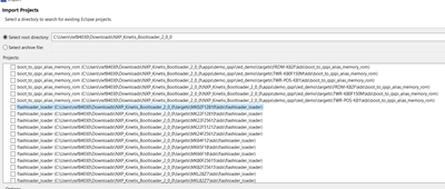

I am planning to use Kinetis Bootloader for above MCU.
https://www.nxp.com/webapp/sps/download/license.jsp?colCode=NXP_KINETIS_BOOTLOADER_2_0_0&appType=fil....
Want to use Blhost application to send commands through UART.
Which files from the Bootloader package should I compile as there is no specific instruction in reference manual and no organization in the package as to which files to include for the blhost application.
Which files should I compile for the Blhost application to successfully communicate with the Bootloader?
1,240 Views
Pavel_Hernandez
Hello, my name is Pavel, and I will be supporting your case, on the root (C:\Users\user\Downloads\NXP_Kinetis_Bootloader_2_0_0\doc) you can find the documentation about the package, if you open the IDE and do the steps to import a project and select the file NXP_Kinetis_Bootloader_2_0_0 will show all the projects.
