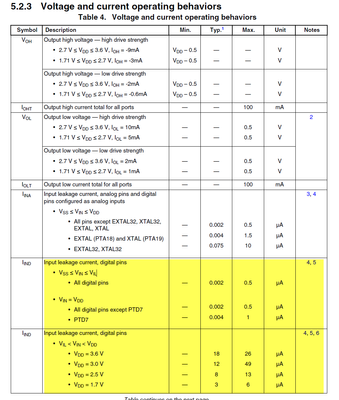

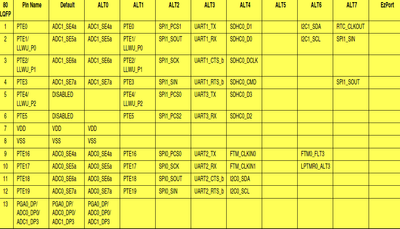

For Kinetis K10 family, some pins are multiplexed with analog channel, if you configure the MUX as 0, the pad is configured as analog channel, the digital input and output buffer are disabled automatically.
If you configure the MUX as non-zero(digital mode), the digital input/output are enabled automatically, if the pin is in digital input mode, the pad is in high-impedance, the input leakage current is in "uA" level, so the pad has high impedance.

Thank you for your response. So for example, pin 6 (PTE5) which does not default to analog but rather to 'disabled' state. If I leave that disabled pin floating, should I expect any shoot through currents? What am I to expect from a disabled state? I am assuming that disabled means the input and output buffer is disabled. But that statement is a bit too vague to draw any conclusion about possible EMI issues if its left floating. It's not very clear from the manual.

For unused GPIO pins, we suggest you connect external pull-up or pull-down resistor rather than float so that the pin has a fixed high/low logic because the pin is in input state with high impedance, in this way, the chip can reduce current, reduce EMI. Of course, if the pin has internal pull-up or down resistor, you can use software to enable the pull-up or down resistor.
Another method is to configure the GPIO in output mode and set/clear the pin logic.
