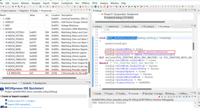

We have a board with the K60 processor where we initiate the Watchdog to have one second timeout, and using the LPO Clock Source.
const wdog_config_t config = {
.clockSource = kWDOG_LpoClockSource,
.prescaler = kWDOG_ClockPrescalerDivide1,
.timeoutValue = 1000UL, // 1 sec WD timeout
.enableWindowMode = false,
.windowValue = 0UL,
.enableUpdate = true,
.enableWdog = true,
.workMode = {
.enableWait = true,
.enableStop = false,
.enableDebug = false},
.enableInterrupt = false
WDOG_Init(WDOG, &config);
Then we use the NXP function, WDOG_Refresh(WDOG), to reset the watchdog within the timeout.
This doesn't work, the controller enters reset.
If we change the clock source to kWDOG_AlternateClockSource, and update the .timeout Value to 48000000UL, to achieve one second timeout, it works.
Is there any thing we are missing for the LPO Clock Source mode?
Thanks in advance!

hi,rlEmbi
Thank you for your interest in NXP Semiconductor products and the opportunity to serve you, I will gladly help you with this.

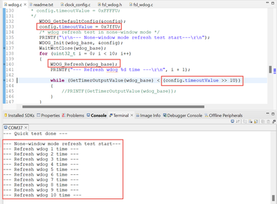

The twrk60d100m_driver_examples_wdog demo in SDK 2.2.0 describes Watchdog operations.In the demo, the LPO clock 1Khz was used without frequency division, as shown in the figure below.
I did some tests, using WDOG_Refresh(wdog_base), and then set timeoutValue to 3FF, found that it worked, there was no reset in timeout, I put the code in the attachment, hoping to help you.
Wish it helps you.
If you still have question about it,please kindly let me know.
Xu Zhang
