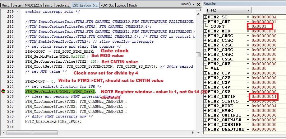

I have a FDM-KE02Z20M board, using IAR Kickstart for ARM development tools.
I am using FTM2, CH0 to capture a rising edge event. I also want to reset the counter to a small value after processing the capture, so that the counter effectively restarts from zero. If, for example, the capture processing takes 5us, I want to set the counter to the count equivalent of 5us so that the time between capture events is correct.
According to the reference manual, writing ANY value to the CNT register sets the counter to the CNTIN register value. However, I do not see this occurring. I set the initial value like this:
FTM_SetCounterInitValue(FTM2, 20); and I can see, that, in fact, that value is in the CNTIN register if my breakpoint is reached in the capture function. However, FTM2->CNT is always zero after reaching this line in the code:
FTM2->CNT = 20;
Theoretically, it shouldn't make any difference what value I use, according to manual, "Writing any value to COUNT updates the counter with its initial value, CNTIN."
What might I be doing wrong here? CNTIN is set to 20.

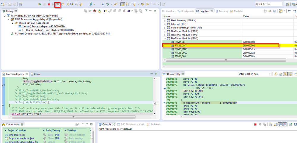

Hi Dave Telling,
      Your configuration is wrong, you can't set CNTIN to 20, when your FTM2 work in input capture mode, please take care the note in page 401 from MKE02Z64M20SF0RM:
        The Input Capture mode must be used only with CNTIN = 0x0000.
        Then, when you :Writing any value to COUNT updates the counter with its initial value, CNTIN. This function works ok on my side.
        My test result is like following:
    1: Before write any value to FTM2_CNT,the  CNT is 0x3a.
2:  After work one step through: FTM2_CNT =20; the CNT value is 2, it is very near to 0,  this means your CNT is updates to the initial value , 2 is just when your reading, the CNT cout to 2 from 0 again.
Wish it helps you!
If you still have question, please contact me!
Jingjing

However, no matter what I do, even if I do not have the FTM2 set as input capture, if I set CNTIN to 20, whenever I write to the counter, it always goes to zero, NOT to CNTIN.
See this from debugger:
Note: I commented out my normal initialization code so that all I am doing is setting up FTM2 counter clock and registers.
Any Freescale techs want to weigh in on this?

Jingjing,
You are correct - the manual does say this. I wish it said it earlier in the FTM section. So, there is not way I can do what I want - very disappointed in this restriction. Thanks for your time!

Hi Dave,
I think there would be two possible reason.
1) FTM clock was not supplied.
2) You read the value from a debugger.
Yasuhiko Koumoto.
