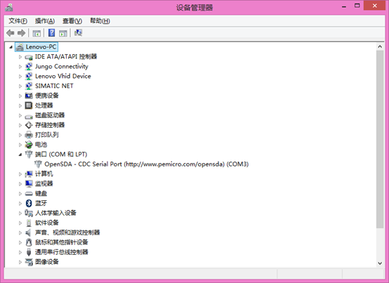

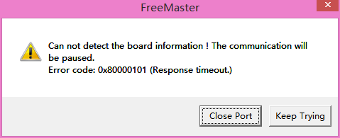

2.In addition, there was a problem with my evaluation board communicating with freeMaster. I could to connect via Direct RS232 because I did not have the conversion module for USB2CAN, but there was a problem with the screenshot. What should I do? Thank you .

Regarding the failure communication of freemaster, pls check the jumper setting or software configuration.
