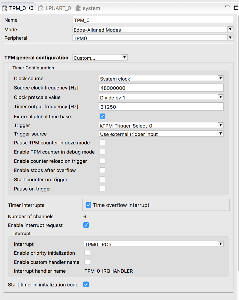

I created a new product using..  New / MCUXpresso IDE / New C/C++ Project. I selected the correct CPU, no board, I selected the correct package (VFM4) and some drivers. I then configured the clocks and basic Peripheral settings via the GUI:-
This generates code which seems sensible and compiles.
I add the app IRQHandlers with basic code to clear the flags.
When I run it, it crashes when an IRQ occurs. My IRQ functions are never called. I've tried TPM, UART and other IRQs and they all have the same problem- when the triggering event occurs, the PC ends up at 0x1C002228 without touching my IRQ code.

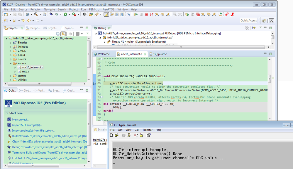

    You can import the SDK_2.3.0_FRDM-KL27Z\boards\frdmkl27z\driver_examples\adc16\interrupt
    This is the ADC interrupt code, I can make it works, when the interrupt occur, it works OK.
   Please check this picture:
You can try the official code at first, I have test it on my FRDM-KL27 board, it works OK.
