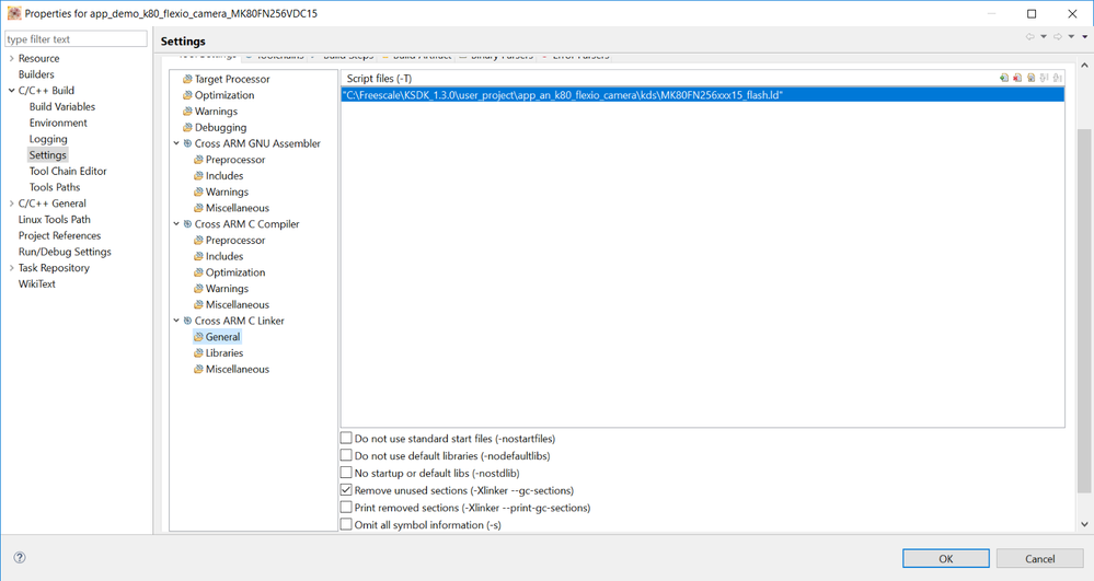

We initially had 6 errors but corrected 2 of them by including the missing files manually by following the instructions on webpage: AN5275_SW FlexIO demo compilation error in KDS  shown below.  We are trying to figure out the step in main.c but the application note "Relocating Code and Data Using the KDS GCC Linker File (.ld) for Kinetis" is not there. Do you have any recommendations for the remaining errors?

Attachment is the link file. You should change the project link file at here

Thanks for the response, I am referring to the application note and the
AN5275_SW.zip (attached zip file) found on the nxp website. I am unable to
find the .ld file mentioned by you in the kds directory, however other
launches file are do available.
For reference i have attached the zip file and the image. Thanks for the
future response.

Can't you see the attachment I pasted in my reply? Maybe you should change a browser. AN5275sw hasn't ld file. It use KDS's default ld file but need to be modify.
