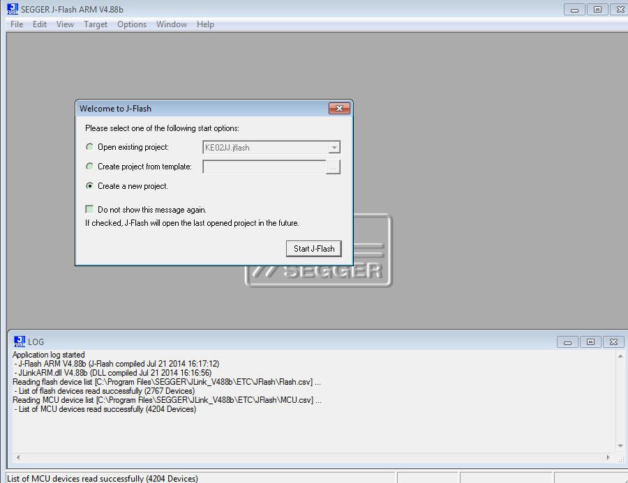

I prepare use SEGGER J-Flash for MKE06Z128VLK4.
But when i execute File->Open Project, i find there are many *.jflash files here but seems no one for MKE06Z128VLK4.
how can i flash MKE06Z128VLK4 with J-Flash? is it means i can't do it? Thanks in advance

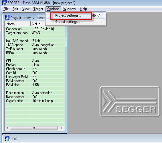

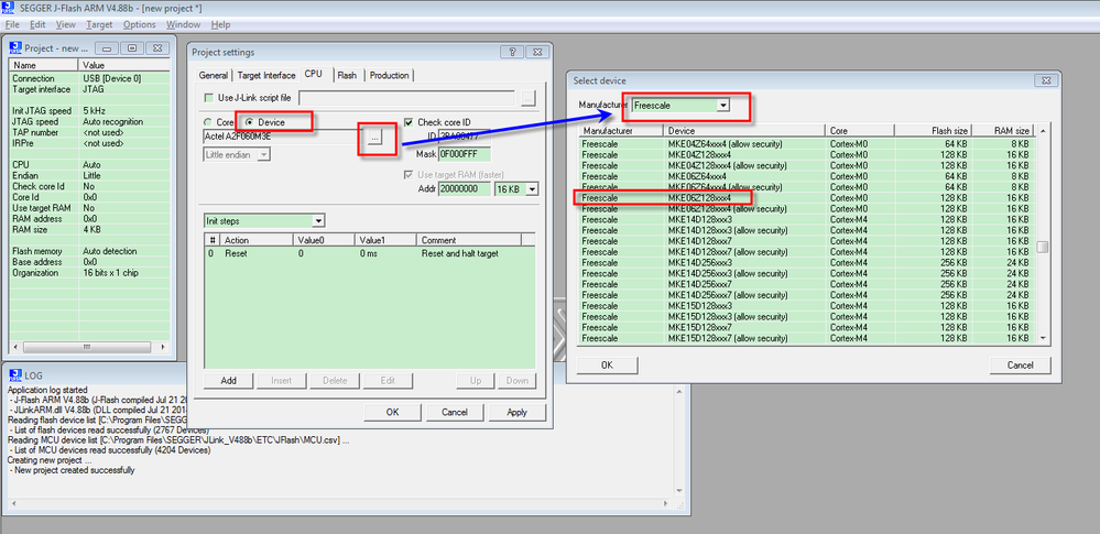

You can use “Create a new project” instead of "Create project from template".
Just refer to the following step:
1: Create a new project
2: do Project settings
3: Select KE06Z128VLK4, Then save the .jflash, this is what you needed.
Wish it helps your.
