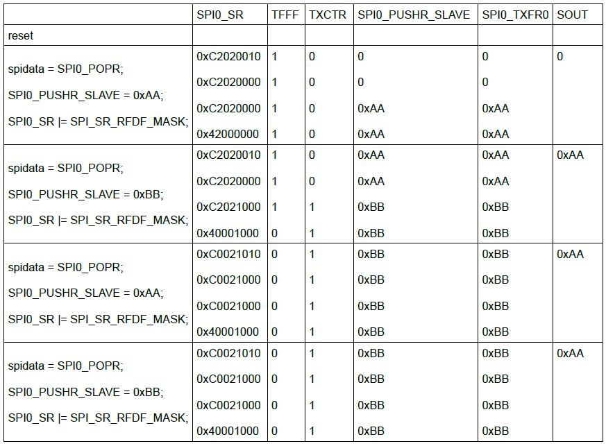

I apologize for the late response. I have some suggestions to do in order to test the behavior of the SPI module.
Debug the code an set a breakpoint inside the else statement to ensure that the instruction is being executed an check the values written to the SPI0_PUSHR_SLAVE register when the instruction is executed, if you are not using FIFO then you have a one entry FIFO, please check the value stored there to see if the value is being stored or not.
Also it is possible that the FIFO is ignoring the writes to it because is full, you can check the TFFF flag just before trying to write to the PUSH register to ensure a empty FIFO (a full FIFO ignores any attempt to write to it).
Hope this information can help you.
Adrian Sanchez Cano
Technical Support Engineer
4,096 Views
stoneface
Hi Adrian,
I debugged the code as you proposed.
The interrupt routine is as follows:
PE_ISR(SPI)
     /* Write your interrupt code here ... */
     // save the input data
     spidata = SPI0_POPR;
     // set the FIFO register with some value that should appear at the output next time
     if (cnt==0) {
          SPI0_PUSHR_SLAVE = 0xAA;
          cnt = 1;
     } else {
          SPI0_PUSHR_SLAVE = 0xBB;
          cnt = 0;
     // clear the Receive FIFO Drain Flag
     SPI0_SR |= SPI_SR_RFDF_MASK;
FIFO is disabled.
The master sends four bytes, so the interrupt is triggered four times.
The receiving of the incoming data works fine, but the flags and registers for the transmitter functions are not as expected.
I also experimented with setting/resetting of several flags at several points, all without any influence on the behaviour.

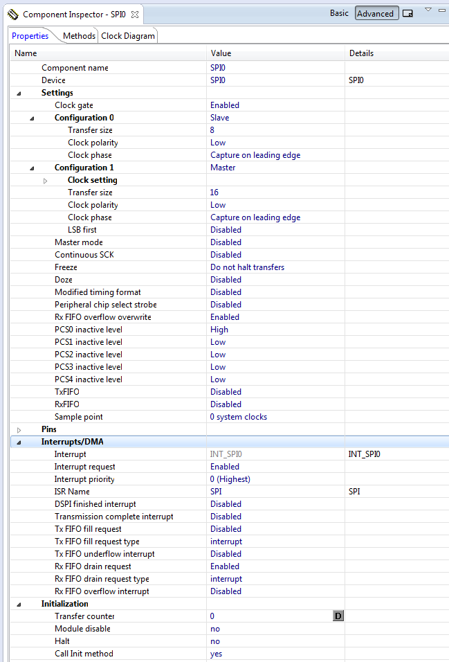

Maybe the initialisation is wrong? This is done with the Processor Expert.
best regards
Jörg
