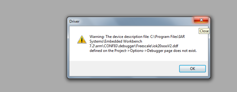

3. But while importing in IAR, I found this.
so, i have chosen other debugger file from available.for debugger, i am using PE micro and using 64k_RAM file.
I am not using Flash
After doing this, i am able to load and run code.

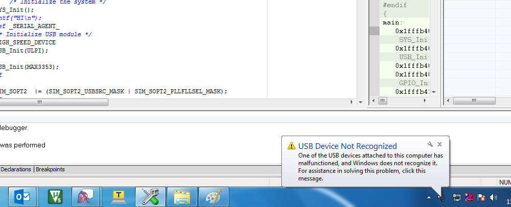

3. Now attaching Board through micro usb cable to my host.
but here, on right side pop up comes as "USB Device Not Recognized".
error1.png"
I have Tried with all Version of USB stack, all Demo (HID,cdc) available in stack.
where i am doing wrong?

3. From where i can have those missed files for debugger and flash loader specified in demo of stack?

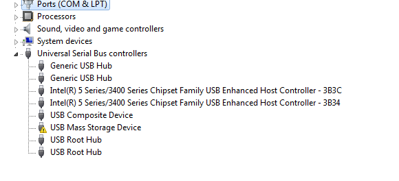

  • .After much efforts, i am succeeded to get msd Example works.Now MSD example is showing my K 20 board as Mass storage device in Device manager.But saying Device drivers not installed successfully.
  • If I do same changes with HID example then it shows as Successfully installed Drivers
  • I am not getting Why msd is not getting worked.

USB-MSD doesn't need a driver. if it is not being recognised it means that it is not working fully, but it is only really possible to know why by monitoring the enumeration with a USB analyser. I don't think that the examples work completely but are just to show enumeration (maybe with a little disk in RAM ?).
Have you tried loading the binary at the link I gave to check correct operation?
If you can't get the IAR project to open in your version you can also use KDS (or CW or Keil, Rowley, etc.) or just run the GCC make file. You can also upgrade the IAR version (to a new Kick Start one if you have no subscription) since this version is adequate for USB-MSD (smaller than 32k code).

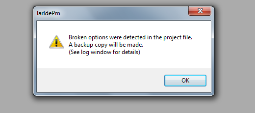

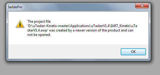

When I am following steps given by you it shows this error.

The IAR version is for IAR 7 and I have no problems opening the .eww with IAR 7.70.2. Possibly your 7.40.3 version can't open it since it was saved with 7.70 (? Although I would expect IAR to be better than that - since IAR 5 (which trashed projects when opened with different versions) I think that they got their act together). I have attached an old version for IAR 6 (it will miss a few new project files but these can be added manually) which should at least allow an upgrade.

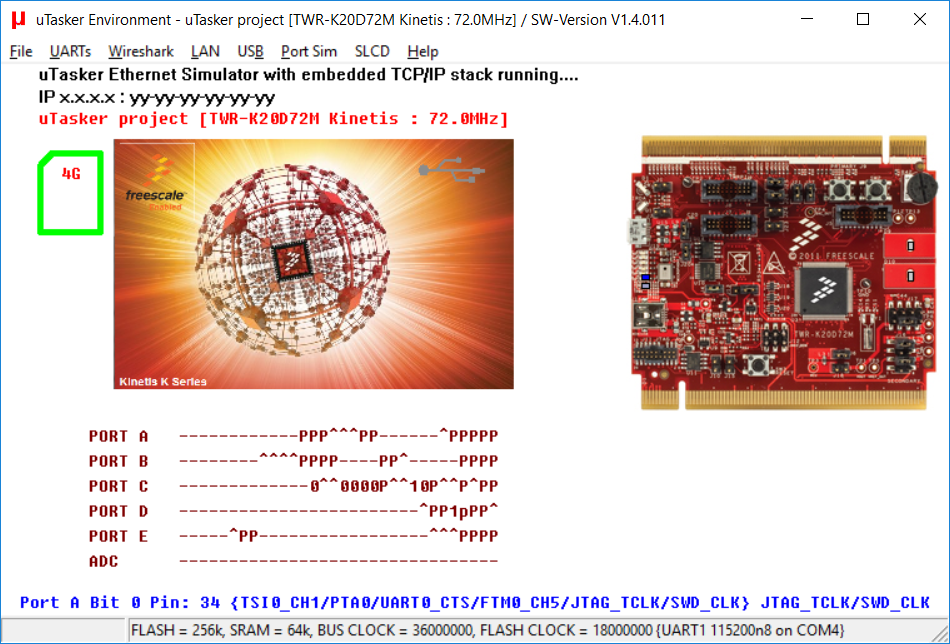

Complete operating source for USB-MSD to SD card is available at http://www.utasker.com/kinetis.html which includes an IAR project for your board and can be used with an SD card or internal Flash and mixed with various other USB device composites.
Documents and videos at http://www.utasker.com/docs/documentation.html
To build what you want:
1. Open the uTaskerV1.4 project by loading \Applications\uTaskerV1.4\IAR7_Kinetis\uTaskerV1.4.eww to IAR workbench
2. Set the K20 target
3. Set the linker script to \Applications\uTaskerV1.4\IAR7_Kinetis\settings\K_256_64.icf
4. In the header config.h select the target TWR_K20D72M (de-select the one that was originally set) and enable USB_INTERFACE, enable USE_USB_MSD (with or without other USB classes) and SDCARD_SUPPORT
5. Build and load to board - finished
6. To do the same in internal Flash use FLASH_FAT instead of SDCARD_SUPPORT - or enable both to have two MSD LUMs, or use FAT_EMULATION to use FAT emutation techniques instead
There is also a command line shell on the UART which has a DOS like interface for viewing the FAT, as well as doing file analysis function (formatting, creating files and directories, delete/un-delete etc.)
The USB device classes are industrial quality with several years of track record in many products - the complete operation can be simulated in Visual Studio for quality reviews, development, debugging.
