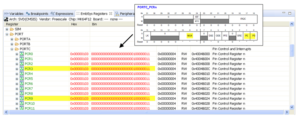

I am having some problems when I try to read the whole PORTC. I find that PTC3 and PTC9 fail.
I am working with a TWR-K64 board with KDS V3.2.0 and Processor Expert.
I configured the whole PORTC as input, with pull up resistor enabled in each of the pins. The TWR-K64 board is not connected to any other board, so ifI read the PORTC value, I should read '1' in each of the pins of PORTC. However, PTC3 and PTC9 are always '0'.
The following pictures shows how the PORTC_PCRn register is configured:
         Bit PE = 1, pull enabled.
         Bit PS = 1, internal pull-up selected.
         Bits MUX = 001, pin mux control at Alt1(GPIO).
The following image shows GPIOC_PDDR register, and confirms that all of the pins are configured as inputs.
However, the same image shows that when GPIOC_PDIR register is readed, PTC3 an PTC9 are '0'.

Ooops... my mistake, now I see you are using a standalone TWR-K64F120M instead
Therefore I just made a TWR-K64F120M version (running at 120MHz from IRC48). I also put the debug interface on USB-CDC due to the fact that the OpenSDA connection is otherwise on some PTC pins.
When the processor's USB interface is connected to a terminal emulator and ENTER is pressed it will print out the same info.
Now I get:
Serial number: 00
Software version V1.4.012
Device identification: KINETIS
Set PORT C to inputs
0x000ffdff
so I can confirm that at least one pin is at 0V (PTC9) - this was J26 (USB power switch).
After removing this I got
Serial number: 00
0x000fffff
For PTC3 you need to check J10. If it is set to 1-2 it will be '0'.
Serial number: 00
0x000ffff7
Therefore I expect that you have missed removing the jumpers.
I attached the binary again in case you don't manage to get the same results with your code.

patricio
Hi Mark,
You were right: once removed the jumpers J26 and J10 everything was right.
Thank you for your help.
