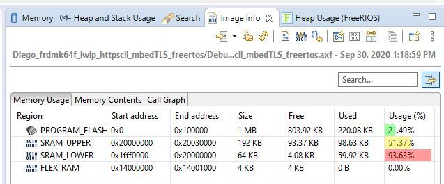

You   a  have a good point , the example  of HTTPS client (that I shared with you),  takes  up to 162K of SRAM Upper , with default options.
Memory region         Used Size  Region Size  %age Used
   PROGRAM_FLASH:      225360 B         1 MB     21.49%
      SRAM_UPPER:      162368 B       192 KB     82.58%
      SRAM_LOWER:          0 GB        64 KB      0.00%
        FLEX_RAM:          0 GB         4 KB      0.00%
To get more a better SRAM  distibution you may try do the following
A) Manually allocate variables on the SRAM lower (which has up to 64 KB)
B) Move global data variables to the SRAM lower using project settings: .
This will free SRAM upper further, and will make use of SRAM lower, please refer to the image info  perspective of the project:
You can also check the image info-> memory contents and image_info->call graph  to get to know the highest memory consumers.
C)
There are plenty optimizations that we could make, the following Erich Styger post on MCU on ecplise provides a good selection of techniques and tips to optimize memory consumption:Tutorial: How to Optimize Code and RAM Size
