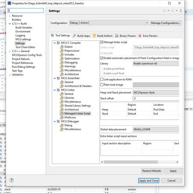

To get more a better SRAM  distibution you may try do the following
A) Manually allocate variables on the SRAM lower (which has up to 64 KB)
B) Move global data variables to the SRAM lower using project settings: .
This will free SRAM upper further, and will make use of SRAM lower, please refer to the image info  perspective of the project:
You can also check the image info-> memory contents and image_info->call graph  to get to know the highest memory consumers.
