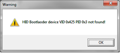

The final issue that is worrying is that the VID/PID that the connected device uses "should" be configurable in the *.imp file but if any combination apart from Freescale's
VendorID=0x15A2
ProductID=0xFF03
is attempted the program also crashes.
This means that I am presently (forced to) setting these values in the HID bootloader.
Therefore I would like to ask Freescale whether this is acceptable and/or whether the PC program could be slightly improved to make it a good tool for Kinetis users with an interest in using its capabilities?

I figured out that the problem is the use of lower case letter for the vendor or product ID (0x03fe) in the imp file. I always use capital letter (0x03FD) and didn't notice the issue. The attached file has fixed this issue.

HIDBootloader.exe: There must be some computer dependency because the new version still doesn't work on my PC, but it "does" now show what the problem is.
In the .imp file I have
VendorID=0x0425
ProductID=0x03fe
but the error message shows:
This shows that the tool has understood the productID as 0x3 and not 0x3fe.
If I use 0x0312 or 0x0400 etc. it works, so I think that the problem with the tool is the conversion of the hex input from the .imp file.
Therefore I have decided to use PID of 0x0400 instead of 0x03fe so that it works with the original HIDBootloader.exe.
