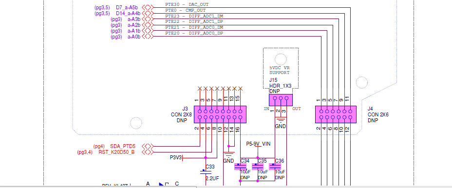

xiangjunrong
Hi, Vinayak,
I have checked, the pin 7 of J4 on FRDM-KL43Z board is  PTE23/ADC0_SE7a. I paste a screenshot, the PTE23 is the third line from right, pin 7 is the third line from right.
Xiangjun rong
5,541 Views
vinayakwadkar
Could you please recheck that  PTE23/ADC0_SE7a is at pin 7 of J4 on FRDM-Kl43Z board ? I just verified PTE23/ADC0_SE7a is at pin 9 of J4 on FRDM-Kl43Z board and at pin7 of J4 on FRDM-Kl43Z board, there is ADC0_SE3 channel/PTE22.
Could you please retest for ADC0_SE7a pin(PTE23) and ADC0_SE4b pin(PTE29) and let us know your result ?
For ADC0_SE4b pin(PTE29), we are also setting MUX bit to 1 to select b channel.
Vinayak Wadkar

5,541 Views
xiangjunrong
I just tested PTE23/ADC0_SE7a with the following code, it is okay. The PTE23/ADC0_SE7a is pin 7 of J4 on FRDM-Kl43Z board. Pls have a try.
Xiangjun Rong
