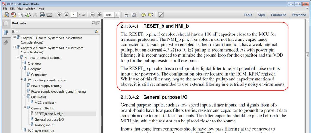

I designed a PCB that takes the MKL03Z32CAF4, I thought the reset pin had an internal pull up resistor but now I'm not sure.  Does it?  Is there a document that describes things such as this and the minimum requirements?

The RESET_b pin, if enabled, should have a 100 nF capacitor close to the MCU for transient protection. When enabled as it's default function, has a weak internal pullup, but an external 4.7 kΩ to 10 kΩ pullup is recommended.
For more detail, please refer Kinetis L Peripheral Module Quick Reference.
