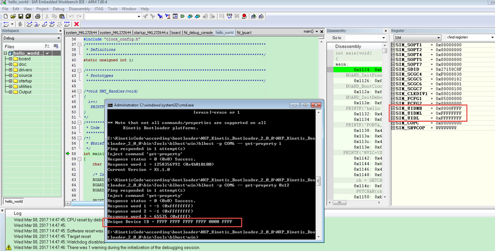

 Yes, the ROM bootloader support the UID read out.
Press NMI and Reset button directly, then release reset at first, then release NMI button.
You can input this code:
blhost -p COM6 -- get-property 0x12
in the NXP_Kinetis_Bootloader_2_0_0\bin\Tools\blhost\win blhost. COMxx, xx should be your own according COM port.
This is my result:
You can find the blhost can read out the correct UID code.
If you want to get the bootloader version, you can use :
blhost -p COM6 -- get-property 1
Wish it helps you!
If you still have question, please let me know!
Kerry

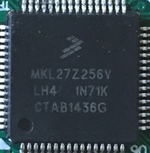

chrismc
Hi Kerry
Thanks for the reminder - the chip picture is below. You can't find any info based on the fact that it's reporting bootloader version 1.0.0?
Cheers, Chris
5,649 Views
kerryzhou
Hi Chris McHarg,
     Thank you for your updated information.
     I have check it with our according department.
    Now, in conclusion, version 1.0.0 chip: KL13Z256/128, KL33Z256/128 , KL27z256/128, KL43Z256/128, KL03
    version 1.1.0 or above: KL13Z64/32, KL43Z64/32,KL27Z64/32,KL33Z64/32
    version 1.0.0 don't support the UID reading, the reversion 1.1.0 or above chip support the UID reading.
