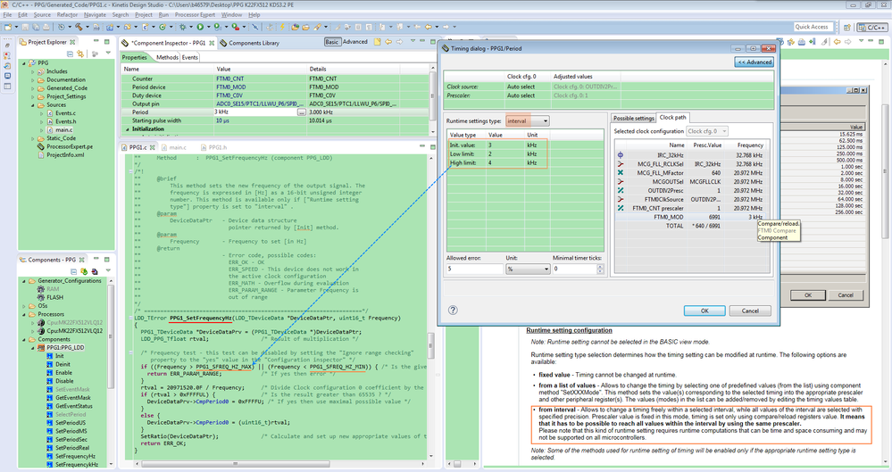

The PPG_LDD can be used generated PWM signal from 2kHz to 4kHz. It was based on modify the FTMx_MOD of FTM module. If you don't want to use the code generated by Processor Expert, you can also use the FTM examples in Kinetis SDK V2.
If you are using MK22FX512VLL12, it have four FTM modules. So I am not sure why you want to generate Tone frequency using GPIO instead of using FTM module.

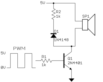

Do you want a waveform to drive the buzzer like this:
The FTM module can be used output waveform with 3.3v. And the PPG1_SetFrequencyHz can be used to change the frequency of waveform at runtime.
The PPG_LDD can be used to output PWM waveform with 50% Ratio. You can set the Ratio to 50% using PPG1_SetRatio16 function.

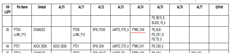

The pin with FTMx_CHx have that capability. For example Pin93 PTD2.
And would you please tell us which pin are you using? Or can you select another pin with FTM capability?

According to data sheet pin 90 don't have FTM capability.
Please suggest me alternate method.
