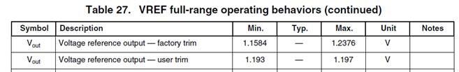

We’re encountering an issue with VREF on MK10DX128VLH5:
VREF_OUT value (in steady state) is 1.182V whereas on other PCB we have 1.196V.
Conditions:
VREF_TRM[CHOPEN], VREF_SC[]REGEN] and VREF_SC[ICOMPEN] bits are set.
VREF_TRIM[TRIM] is untouched.
So we except to reach datasheet figures (between 1.1915 and 1.1977V).
Datasheet specifies two ranges with factory trim:  from 1.915 to 1.1977V or from 1.584 to 1.2376V
 Can you give us more details about these two ranges ? What should be the expected range ?

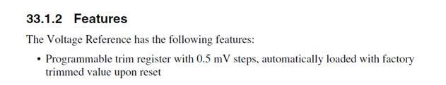

phil74
OK, I understand that voltage will change with temperature.
But spec say that :
Factory trim is automatically loaded at reset.
So, what is the factory trim value automatically loaded at reset.? Is it the one tested at 25°C ?
BR,
Philippe
3,341 Views
egoodii
Senior Contributor III
Certainly -- there is ONLY ONE trim value, and the factory-process is to the specified accuracy (+/-0.23%), and done there at 25C.

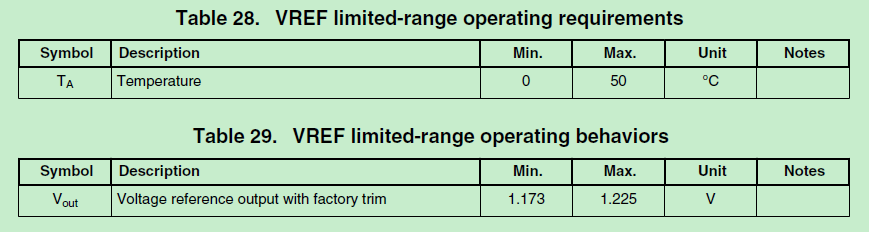

Hui_Ma
VREF output voltage will modify with operation temperature changed.
The K10 datasheet table 27 shows the full-range (-40 °C~ 105 °C) VREF operation behavior, the factory trim VREF output voltage in range of [1.1584V ~ 1.2376V].
Customer also could check the table 29 about limited range (0 °C~ 50 °C) factory trim VREF output voltage range is in [1.173V ~ 1.225V].
Customer need to trim the VREF output voltage with operation temperature modified.
Wish it helps.
Ma Hui

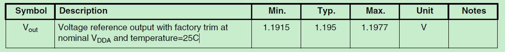

phil74
In fact the question is :
Why datasheet specifies two ranges of factory trim:
1 / from 1.915 to 1.1977V
2 / from 1.584 to 1.2376V
Can you explain me the difference between the two ranges in the datasheet regarding these 2 factory trim ?
So, what is the range of VREF_OUT : 1/ or 2/ ?
BR,
Philippe
3,341 Views
Hui_Ma
The datasheet showed Vout value, one is factory trim (show the VREF module output voltage range), the other one is factory trim at nominal VDDA and temperature=25C (show the VERF output voltage range with factory trim value in typical application condition).
In general application, the VREF output voltage should in range of below range.
Customer should refer below parameter:
Wish it helps.
Ma Hui

Hui_Ma
I had done a test about VREF_OUT voltage with TWR-K20D50M board:
I modified the VREF_TRM[TRIM] bits value with below measured voltage:
VREF_TRM [TRIM] bits value            VREF_OUT voltage(V)
0x23 (default)                                       1.1918
0x0 (Min.)                                             1.1740
0x3F(Max.)                                           1.2058
0x26                                                     1.1932
0x27                                                     1.1940
0x28                                                     1.1946
0x29                                                     1.1950
0x2A                                                     1.1956
0x2B                                                     1.1960
The datasheet provided factory trim value is VREF module could trimmed output voltage range.
In general, customer could not reach this range.
The user trim range is customer could trimmed VREF module close to typical output voltage value 1.195V in full chip operation voltage and temperature range.
As my tested, the trim value 0x29 could get 1.1950V VREF_OUT voltage, which is most close value to 1.195V in my test environment.
In application field, customer should refer user trim range.
Wish it helps.
Ma Hui
