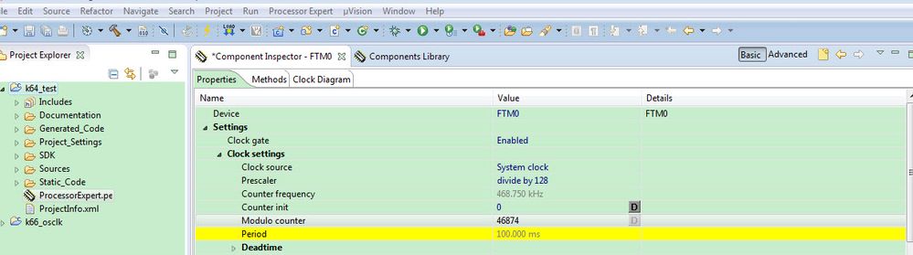

Hi Jingjing,
I was trying to use Init_FTM from processor expert.
I was wondering if I could increase my period?
Is this(128.002ms) the maximum period I get? I want a period of 500ms.
I have attached the screenshot after changing the prescale value and the modulo counter.
Also, I'm still confused if I have to use external clock since my pulse is from a function generator?
The following post talks about that - How to count external events with flex timer Mo... | NXP Community
13,061 Views
kerryzhou
Hi Kiran,
  If you choose the bus clock, set the bus clock as 60Mhz and choose it as the FTM clock source, you just can get 139.810ms as the maximum period.
  But it doesn't matter, you can configure the 100ms as the period of FTM, after it has 5 period, then you can get the 500ms.
    Enable the FTM timer overflow interrupt, define a user variable as the interrupt counter, when you counter 5 times overflow interrupt, it is 500ms, you can disable the FTM.
Wish it helps you!
Jingjing

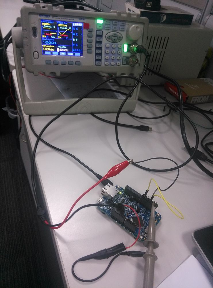

kerryzhou
This is my test result picture:
This is the PTB18 output in the oscilloscope:
13,068 Views
