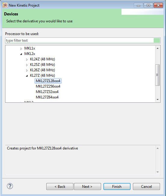

Hello!
I have the Kinetis Design Studio 3.2 installed but fail to get direct support for any members of the KL27 family (MKL27Z, specifically.)  Is there a way to add support / which processor should be chosen instead.  Main use would be verification of clock / oscillator settings.

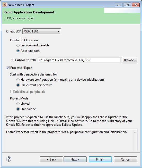

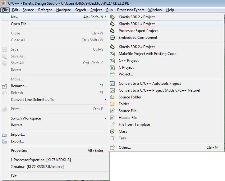

Hi Jaakko,
If main use would be verification of clock / oscillator settings, you may create Kinetis SDK1.x Project with Processor Expert.
Please download the Kinetis SDK v1.3 from Software Development Kit for Kinetis MCUs.
Then refer the steps "4.2 Installing Kinetis SDK into KDS" in KDS_Users_Guide.pdf (This document can be found in C:\Program Files\Freescale\KDS_v3\doc)
After installing you may create Kinetis SDK1.3 Project with Processor Expert.
