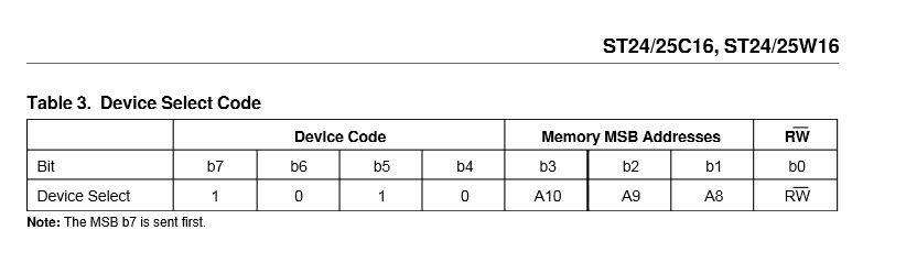

When using the Processor Expert component, I2C_LDD, to access a serial EEPROM, how,is the
device address specified? I am using an ST 24C16 chip. The device select code is the standard
0xA0, plus the 3 MSB address bits. The Processor Expert methods such as SelectSlaveDevice
require the device address as a parameter, But the generated code checks for an address
greater than 127 and flags an error if found.
The 24C16 uses the 3 MSB address bits as a 2K block select. The memory address is the offset
within the 2K block. How is the device address specified to get the 0xA0 sent on the I2C bus?

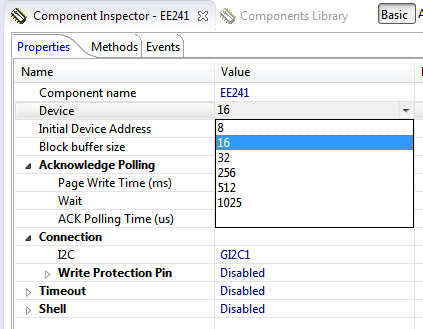

I do have an example (plus a Processor Expert component) for the 24A series of EEPROMS, see https://mcuoneclipse.com/2013/08/18/driver-for-microchip-24xx-serial-eeprom/ .
I think your ST chip is compatible with the Micrchip one. That component supports multiple different devices, including the '16' one:
I hope this helps,
Erich

richardfox75
Erich,
Thanks for the e-mail response. I used your 24xx component. The code works
correctly.

kerryzhou
Hi Richard,
    From the 24C16 datasheet, we can know that, the device select code is like following:
  So, you can configure the device code+memory MSB addresses as the PE I2C target slave address, then write the I2C code, follow the Byte ADDR in the code, this Byte code, you don't need to add in the PE I2C address configurations.
Wish it helps you!
