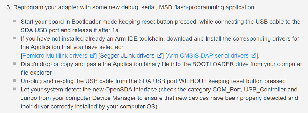

Please check here to download latest OpenSDA firmware for FRDM-K66F board.

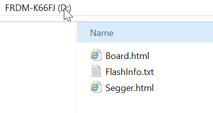

I tested to download Segger J-Link firmware from here and after updated the firmware, I could drag and drop application image (*.bin) to MSD USB disk (FRDM-K66FJ).
About how to update FRDM-K66F on board OpenSDA firmware, please check below picture:
Wish it helps.
