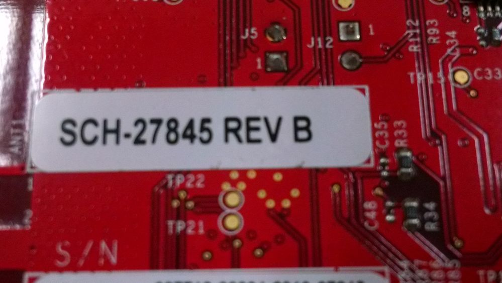

I think I almost run the demo, LCD is work, two zigbees are paired  already. however the data received from zigbee can't display on the  LCD screen.
and used IAR to download program already.
Download three boards, assemble tower and follow the jumper instruction. What else should I do?!

Hello Dongyang Li,
Could you please specify which boards you are using to recreate the problem?

Many thanks for the reply. The following boards are used:
o TWR-SHIELD is on top, with the Qualcomm Wi-Fi GT202 carrier board
seated in the
TWR-SHIELD headers
o TWR-KW24D512 ZigBee Coordinator
o TWR-K70F120M main thermostat MCU
o TWR-SER on the bottom for connectivity
o TWR-LCD-RGB on the side of the Tower.
 ZigBee wireless temperature sensor – using 1323X-MRB-ADC and
1323X-REM
I followed the start-guide exactly. The LCD is work, WIFI is detected,
1323X-MRB-ADC and TWR-KW24D512 ZigBee are paired successfully.
However TWR-KW24D512 ZigBee could not transfer any data to K70 main
board. I checked all the interface signal, no output.
The original demo is using 1323X-MRB-ADC send data to TWR-KW24D512
ZigBee and then pass data to K70, The connection between TWR-KW24D512
and K70 through IIC does not work.
All the jumpers and process are exactly followed guide.
Please help, I brought 12 boards for our department Lab. Please,
provide help...

Could you please specify the revision of the TWR-KW24D512 and the TWR-K70F120M? It is placed in a sticker in the bottom of the board.
Earl.
