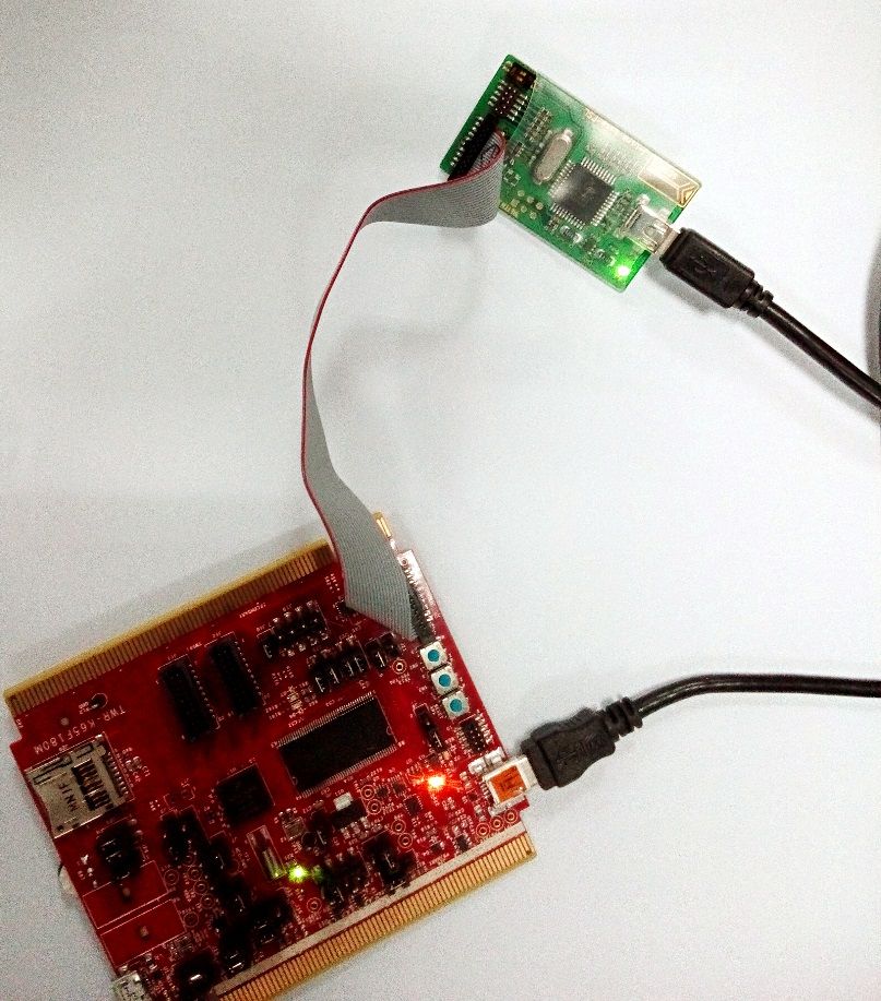

jeremyzhou
Hi Martin
I've reproduced your procedure to debug the TWR-K65F180M.
However I succeeded to debug the board by using the J-link through the J18 interface, as the Fig1 shows.
I'd like to suggest that you need check the hardware configuration again and make sure the setting is completely correct.
If it still doesn't work, please contact with the local distributor to reply for another board instead of this one.
                                                                              Fig 1
Hope it helps.

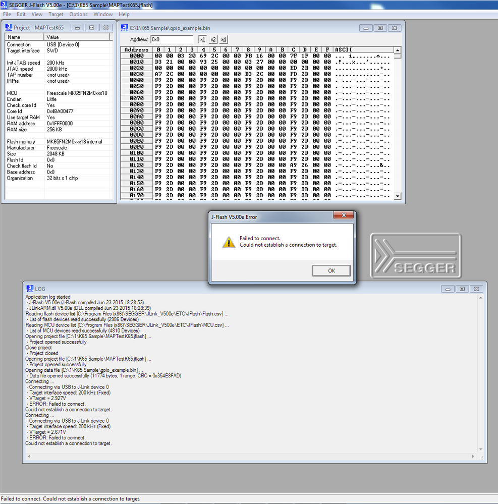

martinfiltenbor
Screenshot. Sure:
Those working with the Segger tell me that it seems their flasher is unable to hold the board in reset during powerup (Segger delivers power through JTAG).
The same Segger Flasher works flawlessly with an aging TWR-K60N512 board :smileyhappy:
By now, we've had a chance to connect a Lauterbach uTrace to the TWR-K65 board and see it work OK. This means the above issue is restricted to use with Segger's Flasher (SEGGER - The Embedded Experts - Flasher ARM ).
